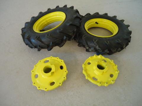

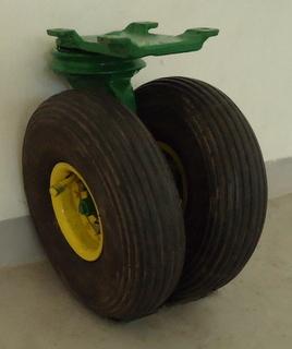

Based on a John Deere type, I wanted to make a usable electric garden tractor.
Started with the flanges of the rear wheels.

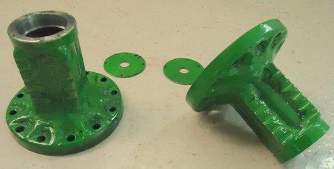

Posted: 11:29am 17 Jan 2024
Shaping the axles.

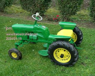

Posted: 11:05am 18 Jan 2024

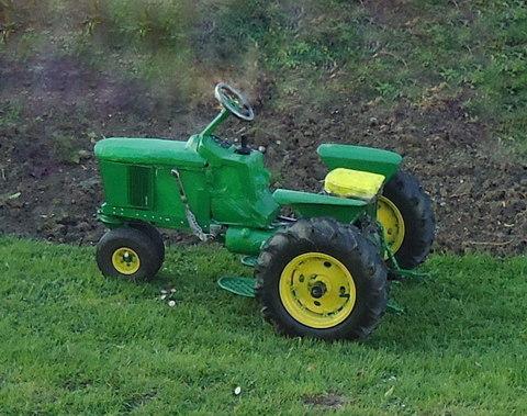

The scale is approximately 1:5 so that the tractor can really be used for work in the garden.

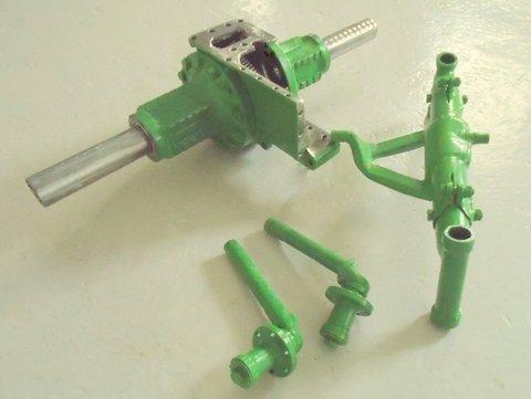

Posted: 10:21am 19 Jan 2024
For a smaller turning circle I made a narrowfront-axle.

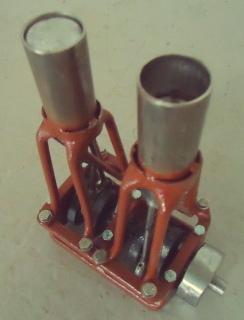

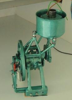

In my tractor model actually fits a water-cooled 4-cylinder engine. That's why I thought about a 4 cyl. solenoid.
I started with a 1 cylinder test setup.

Nice work,  solenoids do work and the timing could be from the crankshaft etc, but how are you going to limit the power to them, PWM speed comptroller or something better?
Ah found it, you used an electric wheel barrow motor instead.

The shaping of a four-cylinder solenoid engine for my tractor is an ongoing project with test setups.

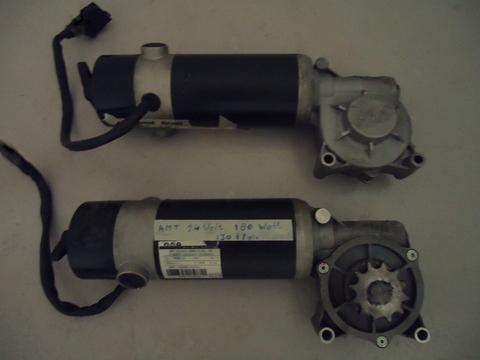

Later I mounted on the rear wheels of my tractor  1 motor for each wheel.

It is fun to do all kinds of work with this little tractor.
I want to mount a sickle bar mower with double knife.

Nice work,
sickle bar mower should work well, they don't take much power to drive them.

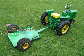

What also comes in very handy is my cart with a low loading floor.
