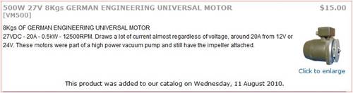

Joined: 09/09/2009
Posts: 2333
Posted: 09:21am 10 Dec 2010
What was the motor out of, or where can one source one, and at what price.
Pete.

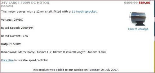

BjBlaster
Joined: 04/04/2008
Posts: 55
Posted: 09:26am 10 Dec 2010
  Downwind said   What was the motor out of, or where can one source one, and at what price.
Pete.
I got mine form Oatley Electronics

Downwind
Joined: 09/09/2009
Posts: 2333
Posted: 12:33pm 10 Dec 2010
Ok thats not a bad deal.
I see a few others there as well that might even be better suited.
Pete.
Edit.....on closer inspection the last motor might be a little high in rpm at 12,500 Edited by Downwind 2010-12-11

BjBlaster
Joined: 04/04/2008
Posts: 55
Posted: 10:07am 12 Dec 2010
Yes it would be much better as the 24V version, but when I got mine the 36V motor was the only top/shaft mounting one they had like that...
