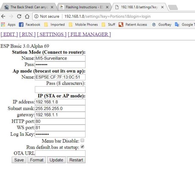

As to ESPBasic
The Flasher for it can be got HERE
Flashing instructions are HERE
It's really simple to use
What I have done is once it Flashed I connected it to my router with a static IP address
Just put your WIFI Name and password in and the IP address you want to use (no changes to the router needed)
Remember to tick RUN default.bas at startup and after you click run the 1st time, any time you reboot it will run automatically
Programming it with the code I have
Just log into whatever IP address you gave it, click on EDIT
and copy and paste the code in there then click SAVE then RUN
it's that simple
The only thing anyone wanting to use it will have to do is get an API key is sign up to Openweathermap API HERE
Once you have your API key just place it in the code in the places where I've said "Put API key HERE"
Also change id=2651357 on each of the line to your local city
You'll find your local city code HERE

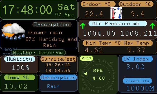

Here's how it looks now
The "Weather tomorrow" box could be used as the forecast button
Ideally when it's finished I'd like to have a logger that will shows graphs of the weather over the past week/month/year and writes to the serial flash chip on the back of the LCD display rather than using the SD Card
I did try changing the pictures to ascii.ppm format so they would run from the serial flash but I couldn't get the pictures converted so they would work.
The reason I'd like to do this last bit is because occasionally I get "SD Card Not Found" when it goes to update the weather icon and also because the SD card sticks out of the bottom of the display and it's going to be a right PITA to get some kind of case for it
EDIT: Updated the Zip file as it had an error in the code*
I also just noticed the pressure for tomorrow has 3 digits, no idea how that happened because I've set it at 2 decimal placesEdited by lew247 2018-04-09
