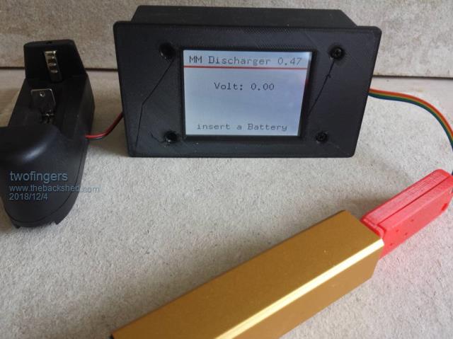

2.8 ILI enclosures
I made my enclosure for Micks 170 BP () and 2.4" and 2.8" LCDs.
I ceated also a case for the "nacked" Serial to USB Adaptors (cp2102).

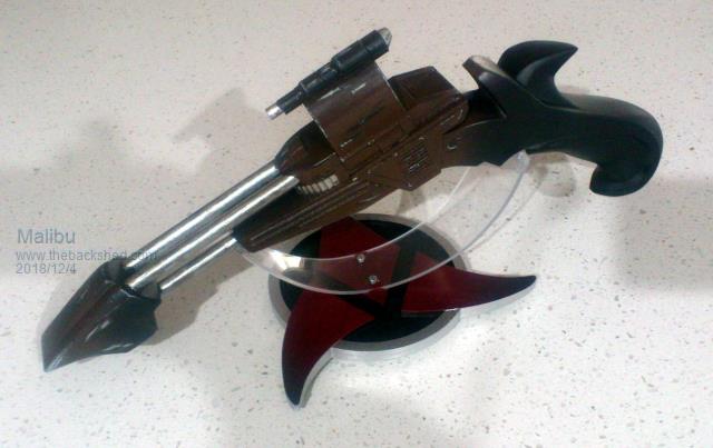

Here's a printed model I did for a mate as a 2nd print (after the factory release owls as a trial, of course!)
Any Trek fans will recognise it
Around 450mm long, it's all completely printed except for the 'barrels' and the curved part of the stand... All in good fun, but it was a learning curve!
