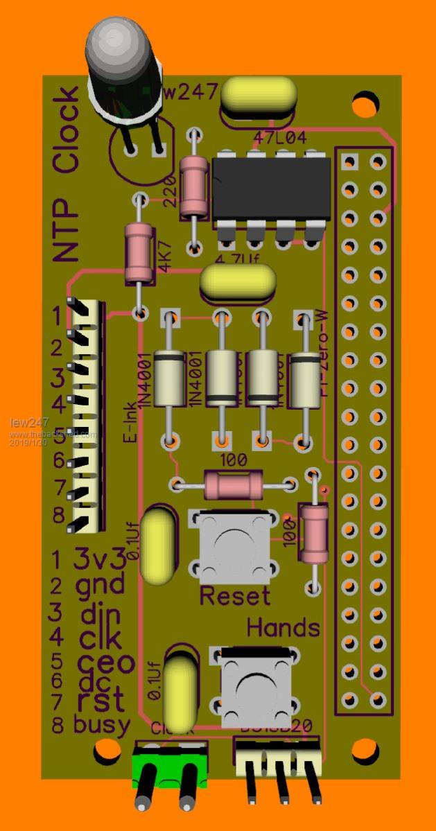

I want to control an AC 2 wire motor that uses very little current, microamps from a Pic
I have successfully done this by having it connected to 2 pins and doing the following
PIN(7) = 1
PIN(8) = 0
pause 75
PIN(7) = 0
PIN(8)= 1
pause 75
I've been told it will work better if controlled using PWM and it can be done from the micromite but despite reading everything I can about PWM and reading the manual I cannot get my head around how it works
Is it possible to do with? and any suggestions how?
it's a clock motor and it has to get a positive pulse, pause and then a negative pulse for the same period as the positive pulse to move one step

It's an analog clock that I'm running from a Pi Zero W and I've made a slight change in the Pi code to get proper NTP time from my local NTP timeservers every 15 minutes so the time is always exact without any fancy code in the MM
The issue I had was moving the hands properly, the motor moves 1 pulse (second) by applying a positive voltage pausing then a negative voltage to move the next second
It was driving me potty because it was moving 2 seconds for every real second
until I realised that I was actually telling it to do exactly that - stupid mistake!
It's working perfectly now and I've had it running for a few days with no errors
Thanks Brian for your "NOT" idea, it actually reading that when I realised that I was telling the code to move 2 seconds for every real second.
I've designed the board so it also has a temp sensor and a connection for an E-Ink display to display the Day and Date and temperature (but doesn't have to be used)
The board below shows a button to move the hands manually if you ever need to but I've removed it in the final PCB
I'm using an Sram that HAS to be set to "00000" when the board is first powered up, and then the clock code loaded
Move the hands manually using the wheel on the back of most clock modules or moving the minute hand only to 12:00:00
Power up and it will start ticking fast till it catches up with the current time and then once per second
If there is a power cut then the Sram writes to it's internal Eeprom and this is the position of the hands in seconds.
Once power is reapplied, this figures is transferred back to the Sram, read and then the hands will move fast until it catches back up to the correct time.
I haven't worked on the E-Ink code yet as I blew my first display by using 5V when the maximum voltage is 4V
Hopefully I'll be able to get it working tomorrow when I'm off work next
The board fits perfectly on top of a Pi Zero W and is a tiny bit wider to allow the pinouts for the E-Ink to be shown
It also has a "heartbeat" LED so you can see it working
I've used a 2.54mm pinout for the DS18B20 so it can be mounted off the board and anywhere on the clock away from any heat
The reset button isn't really needed but it's there in case someone really messes up the hands while the clock is running, it will reset the Pi totally, the power can then be removed, the Sram written with "00000" again and then the MM code loaded after moving the hands to 12:00:00 again
Once I'm happy it all works ok and no issues, I'm going to use a different chip such as ATTINY85V-10SH with an Esp8266 or possibly a receiver to pick up the MSF/DCF/Wghatever radio signal
This would allow it to be run from an "AA" for at least a year or more, or even a "C" for a few years
The other option is once Matherp is happy with his Armite L4 code to use that with a receiver which although won't be such low power as the other chip, it should still allow the clock to run for a very long time on battery
And the E-Ink display can always show the battery voltage as well if wanted so it will be easy to see when it needs changing
Edited by lew247 2019-01-31
