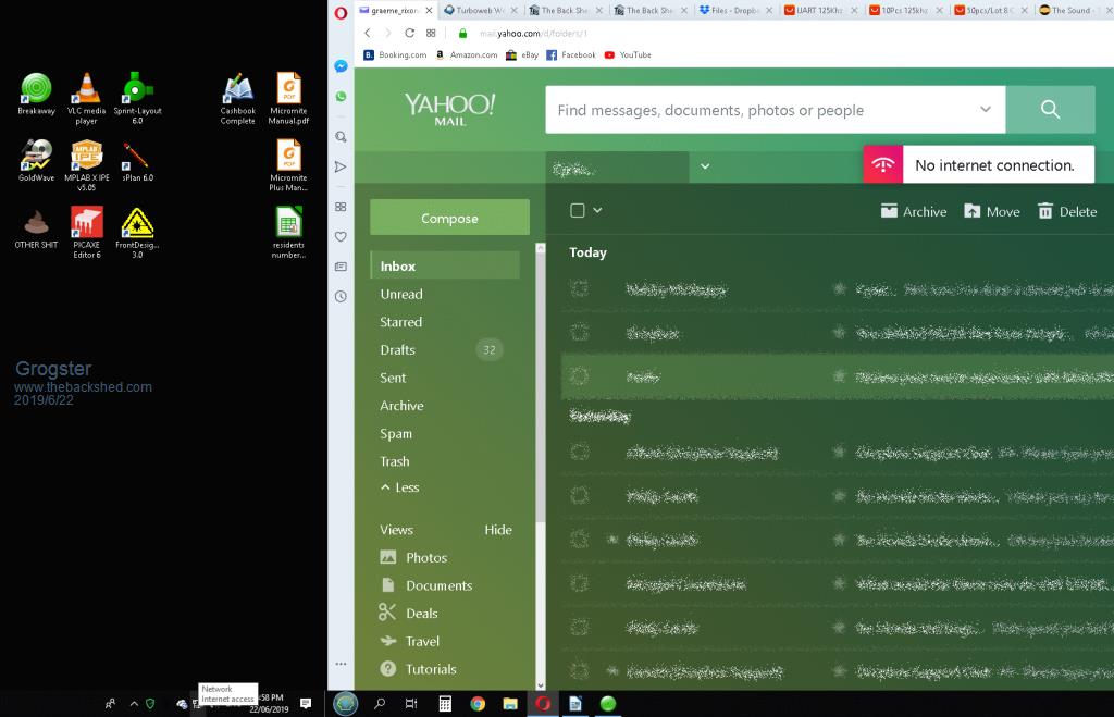

Anyone else seeing this?
Only since MS's last W10 update was rolled out earlier this week, PC will be working fine, then the net will just stop working. All web browsers report "No Internet Connection".
Network icon in task-bar reports "Internet Access"
One contradicts the other.
NOTHING I can think of to do fixes this once you are locked out(reset network adaptors, clear DNS cache etc), and the only way to get the net back, is to reboot. This is actually more of a pain in the arse then you think, as I have two monitors, 16GB of RAM and have lots and lots of different applications all running in the background all the time. The machine runs 24/7, I only turn off the monitors at the end of the day.
A full-reboot takes anything up to five minutes by the time I have loaded back all the applications in the background, and loaded any files into those, along with reloading all my current webpages etc - its a right royal pain in the arse.
The other machines on the same network(not W10 ones, Linux and W7) never lose their access to the net when the W10 box does. I left an old W7 machine running for a few days till this happened again on my W10 machine, so I could check it - W7 still had access to the net, but the W10 one does not.
No error messages, no odd behaviour, the net just seem to go from working fine one instant, to dead the next.
Has anyone else with W10 seen this since the last update?
Does anyone have a command-line or other application that I could try to run when this happens, to simply reset the internet connection as far as the local machine is concerned?

Just happened again now. Mother ....
Ping command says it cannot find the host. I just tried to ping yahoo dot com.
An image of the problem I am seeing:
I have censored all the email messages for privacy, but you can see the "No internet connection" message in the web browser, and the "Internet access" message on the network taskbar icon.
One directly contradicts the other, and I am left scratching my head.
