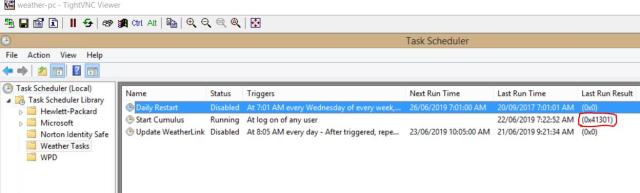

Phil23
Joined: 27/03/2016
Posts: 1667
Posted: 11:32pm 22 Jun 2019
This.....
The task still running....
I think I need it to reach the "Completed" state once CumulusMX.exe is launched & running.
Posts: 6606
Posted: 12:11am 23 Jun 2019
Never liked the scheduler, I prefer to write my own or use a windows version of CRONTAB
I would definitely use a batch file and get that working and exiting first.
You probably need to start Cumulus with "start" in the batch file so it will complete.

Posts: 6606
Posted: 07:13am 24 Jun 2019
This ZIP contains cron, sendkeys, and a couple of batch files.
You will need to change the path to your EXEs
sendkeys is my version of AutoHotKey
To start CumulusMX from a batch file, you need to CD to the program folder first.
If you use START in a batch file so the batch completes, you need to specify the window title or sendkeys can't find the window to send ctrl-C to it. See startMX.bat
You should be able to combine the actions into one batch file but start with individual files.
