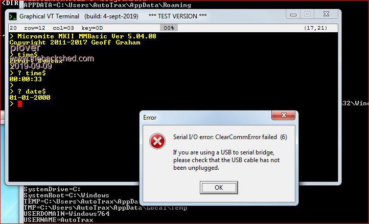

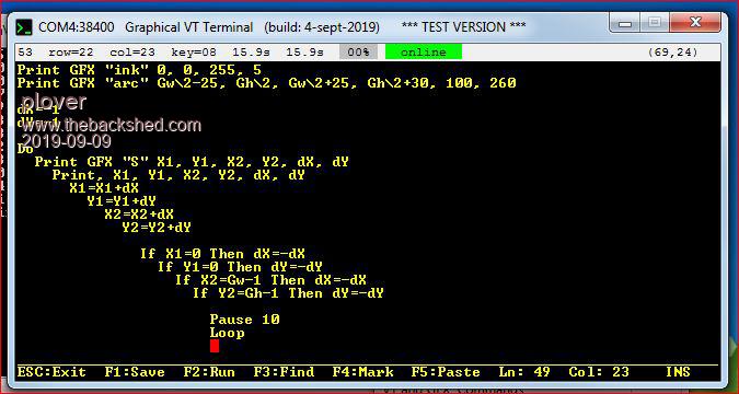

I have had trouble running the two programs, 'Demo' and 'bouncing ball' Initially I had no trouble, I would load mainly 'paste > from text file' and away the program would run.
Then at some stage I went in to the editor and accidentally made change to the programs I believe.  Mainly not realising that hitting the F2 key to run probaly saved the file with my changes before running the program.
The 'Demo program' I compared with the original and realised it was missing a the last 'LOOP' statement and adding this in and saving the file seems to have fixed the problem.  The sinewave nicely rools over the table being printed in the terminal.
The second program 'bouncing ball' gave me a real headache. I could 'paste > from text file', I could see the program loading and it would execute but stumble, some missing LOOP.
The program would stop, with the command line prompt (>) and if I went into the 'Edit' mode I would find the previous program being displayed.
I tried clearing with alt-c, alt-d, and alt-a then doing a 'list' giving me no output. Then loading the bouncing ball.
I believe I have done this a number of times. Then the program would try and run and falter. Then on the last try the program again loaded but stopped at the last line. No automatic run took place. Gingerly I type in 'run' and the bouncing ball is back. So I think I have it working again.
I find that the connection to the E-28 will get lost especially if I forget and walk away from the pc to make a cup of coffe. See following, in this case I was trying to find out where I was, in a Basic program or just the command line and system did a flip.

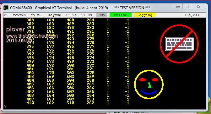

Below is the loading of the 'bouncer' finished and it is not auto running.  AAaaahhh I just noticed that it looks like I have loaded into the editor. Crumbs this may be part of the problem. I have a concern about the indenting, this now seem to be a new problem I am seeing but the program does work. I will look up a note I saw in the documentation about a space after the prompt or something.
Following picture is the bouncing ball snapshot, when it worked.  I stopped the program with 'ctl-c' and moved the pointer focus off the terminal, I love the keyboard sign showing up.  Now red blinking cursor hardly gets my attention, by the time I see the red cursor I have almost automatically clicked the focus to the terminal.
The night has run away from me so it is ZZzzz.... here

one of the problems you are striking is the editor auto indenting as the code is pasted into it. see the earlier post in this thread about pasting into the editor:
  Quote  within the editor, at a blank line press space, then left arrow. this places a space character to the right of the cursor which DISABLES automatic indenting. this is IMPORTANT.
now (as before) from the menu select paste -> from text file. GFXterm will paste from the text file directly into the editor. it liaises with the editor to ensure no characters are lost, so this method is much slower than using autosave.
having text to the right of the cursor (such as a single space) disables the auto indenting, which is what you need to stop the program lines from running past the 80-character limit imposed by the editor.
dropping the usb connection could be a great number of different things. my first suspect would be a dodgy usb plug somewhere, another may be the computer entering a low-power mode when left for a while and shutting down power to the usb port that is supplying the E-28.
you can just press alt-space to reconnect to the same port as was last in use after a disconnection happens.

Thank you for posting, you confirmed that the notice I had seen somewhere in your documentation mentioned the 'space' that should be inserted. When I first read it and tried to test I failed to get it right. After having loaded a program a number of times and not seeing any effect I forgot about it.
I assume that the indenting may or may not interfere with the running of a program. I will look at this way that the 'bouncing ball' demonstrates the effect of the missing space [without harm].
About the 'Disconnection' this could well be due to the pc going to power down which does happen after 30 min and so of inactivity. I will try and pay attention to this as I think the action of the disconnect notice actually triggers the pc to stay in full power mode for another period.  I now remember that when I come back to the computer I may see the notice, ie the computer did not power down at the first trip to do so.
I will have to test the 'alt-spacebar' reconnect.  I have worked out my main confusion, as usual when you know the answer it is simple. Will be my next installment.

Finally I figured out what went wrong for me. I simple terms, I was not clear on where I was or what mode the terminal was in when I tried to 'load' or 'paste from a text file'.
IMPORTANT - Really is IMPORTANT:
1..  When loading/pasting a .bas file be sure to understand the difference between interpreter-MMBasic/edit mode.
2..  As well add the space to turn automatic indentation off in 'edit' mode
Ensuring the two points above, now it looks like plain sailing for me to 'load' a .bas program.
I started mixing up pasting into interpreter mode or 'edit' mode. I would load and run successfully a program in 'edit' mode. Stop the program with ctl-C, congratulate myself with the success go and make a cup of coffee come back and try to load the 'Demo' and to my dismay the program crashed.
I stopped the program with ctl-C, which leaves the process in [b]interpreter[/b] which I forgot. Promptly loading the next program into the interpreter.  Well it may be some weeks before I forget this again.
Perhaps it is possible to test that the load is meant for the 'editor' and warn about trying to load into the 'interpreter.

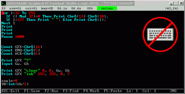

Something I noticed when using the 'edit' mode and try to use the 'select all' I was actually thinking that it would copy the complete .bas program but as can be seen in the example I only get the visible portion in the terminal window.
Is that by design?

  plover said  As I was also experimenting with using 'select area-copy' out of the terminal I discovered that when using 'select and copy' and 'select all' that really does give you all, including the bottom line?   Is that meant to be?
Is that by design?
not so much by design, but rather the product of GFXterm being just a simple terminal emulator.
GFXterm has an array of 24 by 80 characters - one for each character cell on the terminal screen - that it maintains internally. when the screen scrolls, it shuffles around lines within this array. when characters are received from the micromite, they are both drawn on the terminal screen and copied into this array. this is necessary because the terminal screen is a graphical object. once a character has been displayed on the screen for you to see, it is no longer retrievable - it is just a pattern of dots.
when you choose 'select and copy' from the menu, GFXterm cheats. it quickly makes a copy of the character array in a win32 edit control, with trailing spaces trimmed from lines. this edit control is then drawn (by the operating system) in front of the normal terminal window and you interact with it quite independently from GFXterm. When you exit the edit control (with esc or enter) the normal terminal screen is revealed again.
while the edit control is displayed, the terminal window keeps going in the background, you just can't see it.
