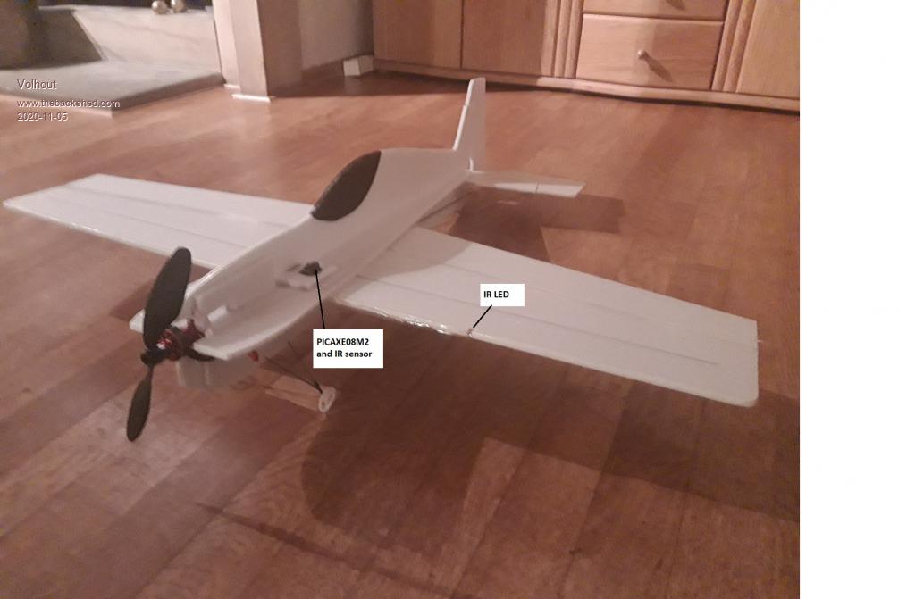

For our model airplane club I developed a tag combat system.
In the summer, we fly larger model airplanes outside, but in winter time wind rain and temperature drive us indoor. We rent a sport hall, and fly with small light electric propelled airplanes.
After having sufficient contact with walls, ceiling and floor, the planes look battered, and the pilots tired.
To bring new energy in the indoor activity I decided to revive up a 10 year old (and never completed) project for indoor combat between airplanes.
The game: pilots equip their plane with a small and light tag. The tag contains a IR sensor and IR emitter (the gun). A spare channel on the remote control receiver can be used to fire the IR gun. The IR receiver receives transmitted codes from competing IR guns (other planes).
Some game parameters make the game exciting. When you are out of bullets, there is waiting time before you have new ammo. When you are deadly hurt, you cannot fire anymore.
The tag remembers who shot you, and after combat you can list this.

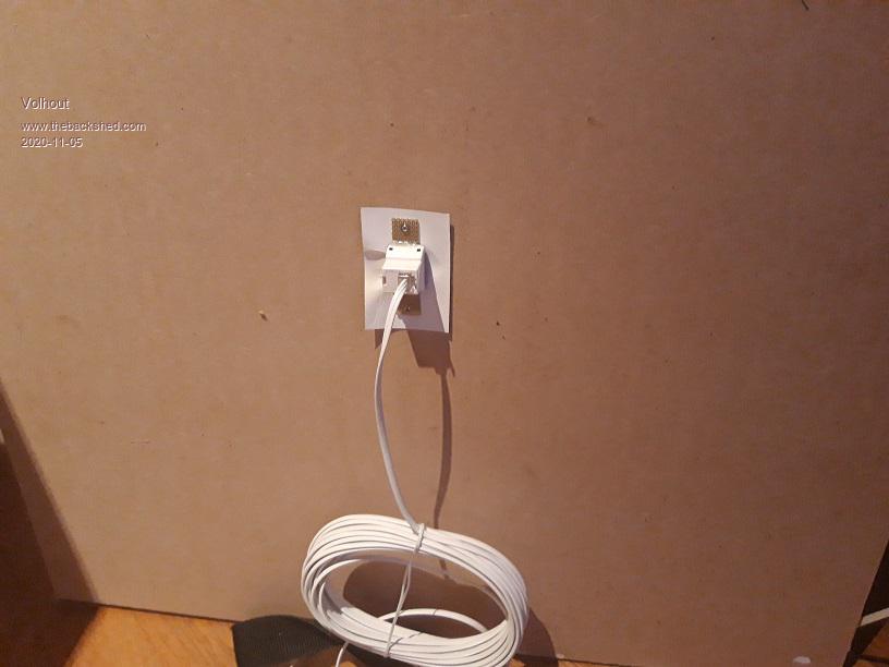

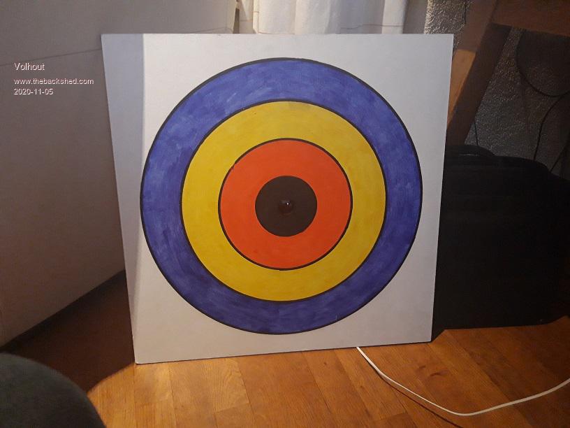

To practice shooting and aiming, a target is developed, based on a CMM1. It decodes IR pulses from the airplane tags, and creates a highscore list.
These electronics have to be very light, the planes are below 200 gram. That is why was chosen for a 8 pin picaxe microcontroller.
Example of the electronics on a plane

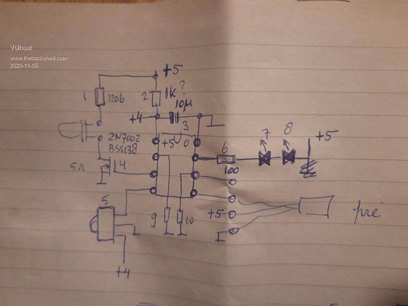

The picaxe has embedded receiving and transmitting of SONY 12bit IR codes. Accidentally the CMM1 also supports these SONY codes. That eases the implementation of the system.
Schematics of the tag (hand drawn sketch)

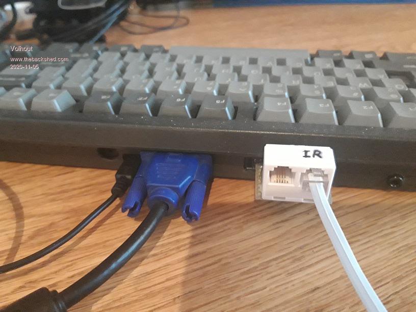

The target runs on a CMM1. An IR sensor is connected (see CMM manual) to pin 12 of the CMM1. Currently the target is connected via a cable (RJ11 telephone cable), but in the future there will be a wireless target.
CMM1 26pin - RJ11 adapter board
The target (front and rear)

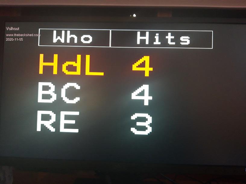

Screenshot of the highscore list
The software that runs on the CMM1

This code is still under development, we are just starting to use it in actual combat. Parameters will be tuned for optimum joy, features may be added (rockets ?).
I already have prototyped a air defense "flak", a IR gun that rotates and elevates towards the attacking plane and fires back.
The idea was to post it here, so it may transpire into idea's for others. The tag can be used in a very elementary "laser combat" suit for kids to play (just replace the pulse measurement of the fire channel with a fire button on the same GPIO pin).
