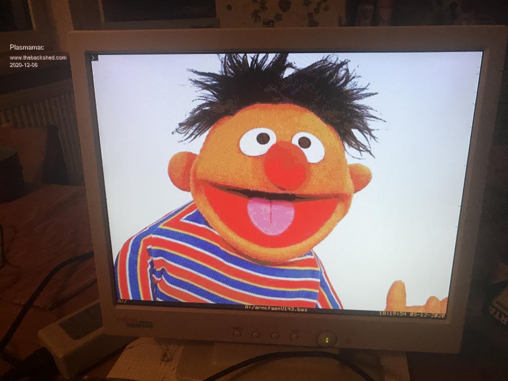

Hi , i Build the cmm2 . I use 5.05.03.
ive got Bad vga. Ok Screen on Startup But much Fish/ glitches if i Display a bmp.
Ive got. much Moore glitches on the hd tv.
Can anyone help ?

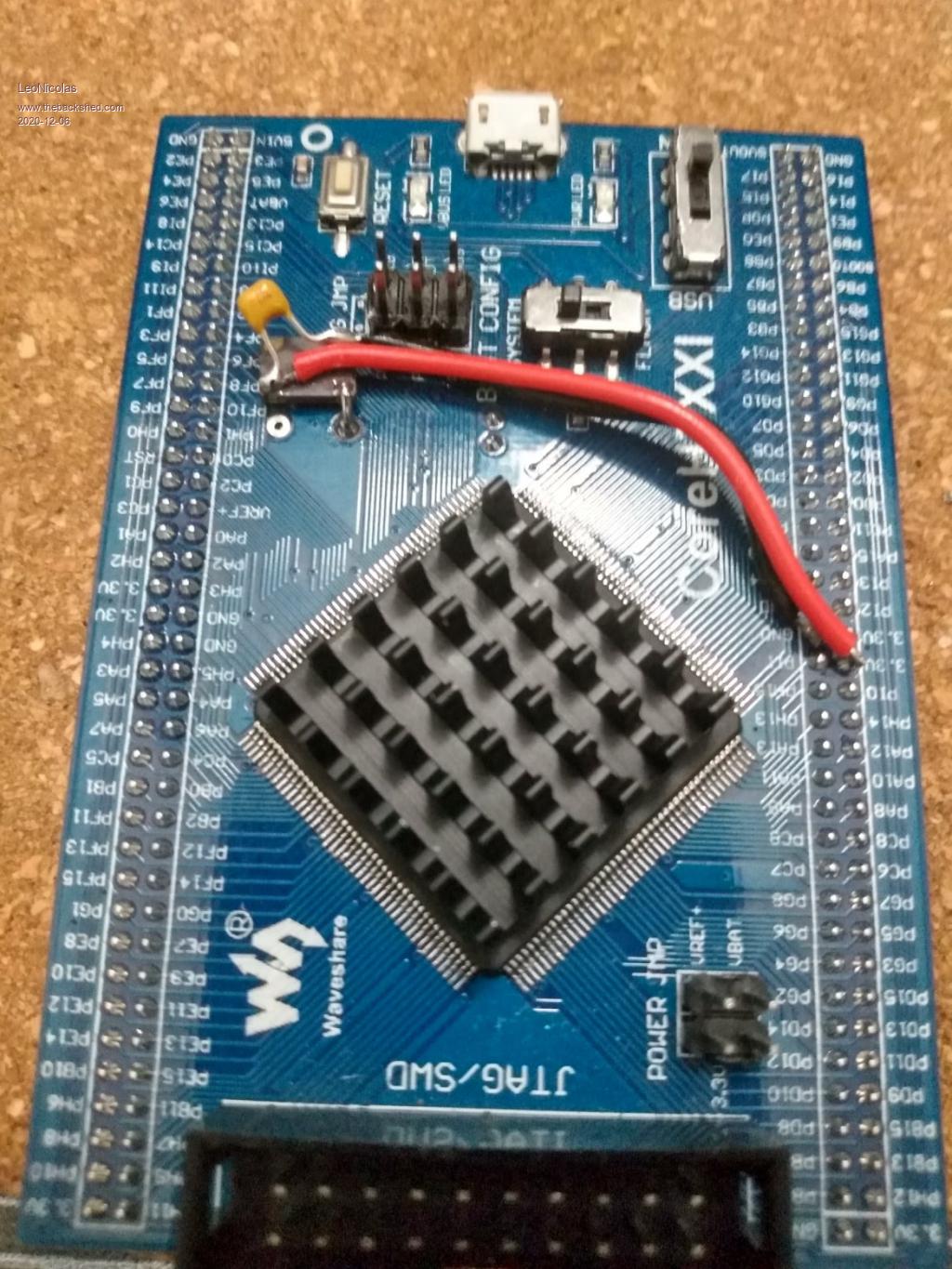

Are you using the Waveshare module?
If you are, you will get a much better video if you replace the 8MHz crystal with an oscillator module.

Posted: 01:31am 06 Dec 2020
I had the same problem and the mod fixed my CMM2.

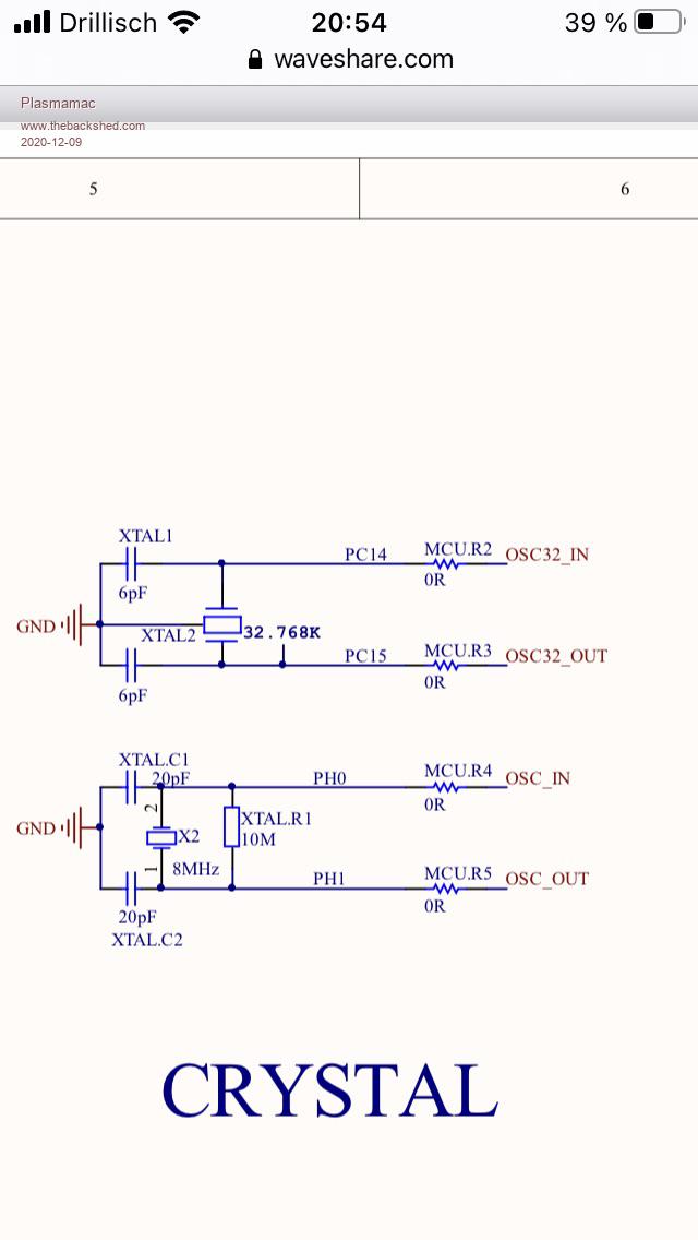

Posted: 02:14pm 08 Dec 2020
Hmm , i wonder Why your Solution will work. I mean the waveshareboard has a Standard chrystal onboard.

Posts: 6606
Posted: 07:51pm 08 Dec 2020
  Plasmamac said  Hmm , i wonder Why your Solution will work. I mean the waveshareboard has a Standard chrystal onboard.
With the standard crystal, the frequency suffers from instability, probably due to slight voltage fluctuations.
The recommended oscillator module does not suffer from this instability which is why it is so much better.
