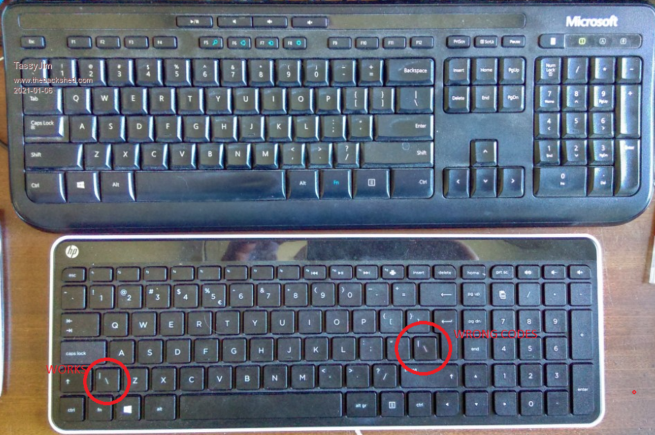

Posts: 6606
Posted: 08:13pm 05 Jan 2021
Does the 'faulty' keyboard have a second pipe/backslash key to the left of the Z key?
If so, that key should work.
My HP keyboard has that arrangement and the usual pipe/backslash works as you describe but the key beside Z works correctly.
I stick with the HP keyboard because of it's compact size.
Edited 2021-01-06 06:19 by TassyJim
Posts: 6606
Posted: 09:03pm 05 Jan 2021
  matherp said  Try the attached and let me know if
1: does it work
2: has it broken anything
CMM2V1.5.zip
With my HP keyboard,
1. Yes
2. No
The original key on the left and the one on the right now give identical codes and I can't find any problems with the rest of the keyboard.
I haven't tried a 'normal' US keyboard yet.

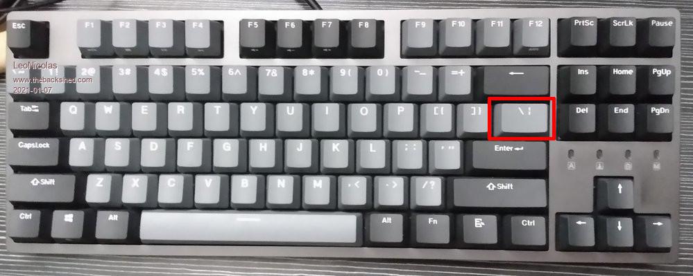

LeoNicolas
Joined: 07/10/2020
Posts: 625
Posted: 04:08pm 06 Jan 2021
My US Keyboard has this key and it works well in my CMM2.
No problems with the | or \ characters.

LeoNicolas
Joined: 07/10/2020
Posts: 625
Posted: 04:16pm 06 Jan 2021
I'm using the last stable version, v5.06.00

I think I understand - Jim's keyboard pictured above seems to have this key duplicated and I assume this is also the case for the OP
yock1960
Joined: 18/08/2020
Posts: 167
Posted: 05:35pm 06 Jan 2021
  matherp said  I think I understand - Jim's keyboard pictured above seems to have this key duplicated and I assume this is also the case for the OP
Just flashed your 'test' beta...awesome. If I see any issues after using it I'll let you know!
