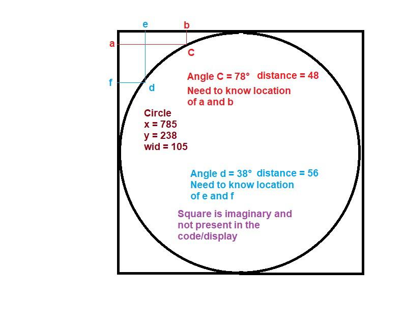

I have a circle on the display and I want to place pictures on the outside and inside in certain locations
I know the X Y and Width of the circle and I know the Angle of where I want the items placed
Is there a formula or easy way to work out where to place the pictures?
In this case it's a compass and the pictures are direction words like NE,NNE etc
the text in the images is rotated to the correct angles I just need to find a way to work out where to place them
an example
place image 1 at 21 degrees and distance is 43 from the centre of the circle
Is there any formula? to work out the x and y positions to place the image?
an image that hopefully explains what I mean
the square outside isn't there I drew it so it's easier to explain what I meant

DIM INTEGER circle_x, circle_y,, x, y
circle_x = 785
circle_y = 238
calc(x, y, 78, 48, circle_x, circle_y)
?x, y
calc(x, y, 38, 56, circle_x, circle_y)
?x, y
SUB calc(xx AS INTEGER, yy AS INTEGER, angle AS INTEGER, distance AS INTEGER, cx AS INTEGER, cy AS INTEGER)
      xx = circle_x + SIN(RAD(angle)) * distance
      yy = circle_y + COS(RAD(angle)) * distance
END SUB

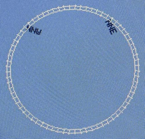

It prints NE,SE,SW and NW in the correct locations on the screen but the code is exactly the same for all 4 other than the angles which obviously tells it where to print the words.
I wanted to add all the sub intermediate coordinates as well and tried to use the same code and add NNE by using
Text 10,10,"NNE",L,7,,RGB(1,1,1),RGB(134,174,230)
Image rotate 6,4,30,30,cx%+(wid%-16)*Cos(.785),cy%-(wid%-16)*Cos(.785),22.5,1
but it doesn't work
Can anyone tell me why it doesn't and how do I work out how to place it?

It still displays them at 45 and 315 degrees instead of 22.5 and 67.5
Text 10,10,"NNW",L,7,,RGB(1,1,1),RGB(134,174,230)
Image rotate 6,4,29,29,cx%-(wid%-16)*Cos(.785),cy%-(wid%-16)*Cos(.785),22.5,1
Image rotate 6,4,30,30,cx%+(wid%-16)*Cos(.785),cy%-(wid%-16)*Cos(.785),67.5,1
Text 10,10,"  ",L,7,,RGB(134,174,230),RGB(134,174,230) ' clear text

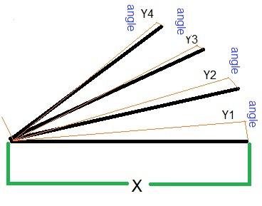

What I'm trying to understand is this
If I know X AND angles 1,2,3 and 4 How do I calculate what Y is for each one?
Edited 2021-01-11 23:32 by lew247

Knowing X is not really needed or helpful. What you need instead of X is the length of the lines from the pivot point to the end of each line.
If we assume that each of these lines is the same length, then it's easy:
Let the point cx, cy be the pivot point. and r be the length of the lines. Then
y = cy - r*sin(angle)
The minus sign is because the direction of increasing Y is down. If your angles are in degrees, don't forget to use the rad() function to convert to radians before taking the sin of the angle:
y = cy - r*rad(sin(angle))
-Bill

Excuse my crude quarter circle (of radius R), but the (x,y) coords for the angle (ang in degrees) is:
     --\ (x1, y1) <- want the coordinate at this location for the angle (ang1)
    _/  --\
  _/       |
/ ang        |
   R = radius
x = R*cos(ang_deg * pi/180)
y = R*sin(ang_deg * pi/180)
So, in your diagram, X looks to be the radius, and the heights for Y1-4 would be
y1 = X*sin(ang1 * pi/180)
y4 = X*sin(ang4 * pi/180)
Of course, in screen coordinates with Y increasing down the screen, you would subtract these Y values from the starting point.
And the X locations on the outside of the circle would be (again with 'X' as the radius)
x1 = X*cos(ang1 * pi/180)

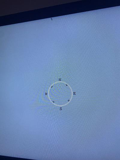

Posted: 03:27pm 11 Jan 2021
I'm not getting it at all
I was sure this would work
It prints the new ones a the top of the screen
Option explicit
CLS RGB(134,174,230)
Dim cx% = 785
Dim cy% = 238
Dim wid% = 105
Dim ang! = 0.087266463
Dim rad90! = 1.570796327  '90 degrees in radians
compass_rose 625,475,75

I can't see why it isn't placing them where they should be
johnd
Joined: 22/10/2020
Posts: 30
Posted: 03:59pm 11 Jan 2021
In your last two Image rotate statements, you have cy% = cx%...., but I think the "=" should be a "-" or "+".  Also, it looks like you have a double "*pi/180) * pi/180)" and I'm not sure what that last ')' even matches up to.
I haven't run this code, but I'm sure the last two image statements are incorrect.  You need something like:
 Image rotate 6,4,29,29,cx%+(wid%-16)*Cos(1.178),cy%-(wid%-16)*sin(0.393),22.5,1
for the NNE and
 Image rotate 6,4,29,29,cx%-(wid%-16)*Cos(1.178),cy%-(wid%-16)*sin(0.393),22.5,1
for the NNW
I'm not positive this is correct (since I'm not running it directly) but it should be closer than what you had, especially with the '=' and extra "*pi/180)" code.
note: in previous code 0.785 = 45*pi/180 and 0.393 = 22.5 *pi/180. and 1.178 = (45+22.5)*pi/180
