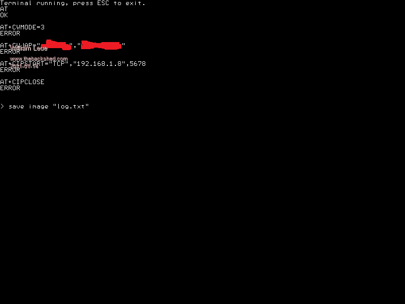

I am hoping the hive mind can help with a problem I am having.
I have a CMM2 Deluxe unit that includes an ESP8266 WiFi radio and controller. I am trying to write a simple program in MMBasic that would let me connect to a local TCP/IP server.
I can open a COM1: connection to the controller, and it responds to "AT" with "OK" as it is supposed to. But things go downhill from there. All the other commands I send just return ERROR.
Here is the short and simple program I wrote to test this:

(I masked my local WiFi network name and password for obvious reasons.)
Here is the log of the program, with the network name and password again masked.
Any hints will be greatly appreciated!

Posts: 4379
Posted: 05:36pm 13 Jan 2021
Your print #1, cmd$ (where cmd$ is "AT") will send both CR & LF I think but your device probably only wants one of them.
If you use
print #1, cmd$;
that will suppress both and you can add whichever you need either to cmd$ or do something like
print #1, cmd$+chr$(x);
where x is either 13 (for CR) or 10 (for LF).

William Leue
Joined: 03/07/2020
Posts: 411
Posted: 05:57pm 13 Jan 2021
Well, I tried that but am still getting the same ERROR returns. I tried first with NL and then with CR but get the same problem with either.

Posts: 11873
Posted: 08:03pm 13 Jan 2021
What firmware is in the ESP8266? From what I remember Piotr puts something wacky on them (bulletin board?)
Posts: 6606
Posted: 08:26pm 13 Jan 2021
I thought he has put zimodem on to them.
ATW"[SSI],[PASSWORD]" : Connects to the wireless access point with the given SSI, using the given password.
ATD"[HOSTNAME]:[PORT]" : This opens a streaming connection between the terminal and the given host/port. Use "+++" to disconnect and exit back to command mode.

frnno967
Joined: 02/10/2020
Posts: 105
Posted: 11:16am 14 Jan 2021
The ESP has the Zimodem firmware, not the stock ESP firmware which supports those commands you're using. Search for Zimodem and you'll find Bo's github page detailing the commands.

William Leue
Joined: 03/07/2020
Posts: 411
Posted: 02:24pm 14 Jan 2021
Yes, I am getting a lot farther using the Zimodem commands. Not quite working yet but network connection is good, and I am working on sorting out the TCP/IP server connection.
