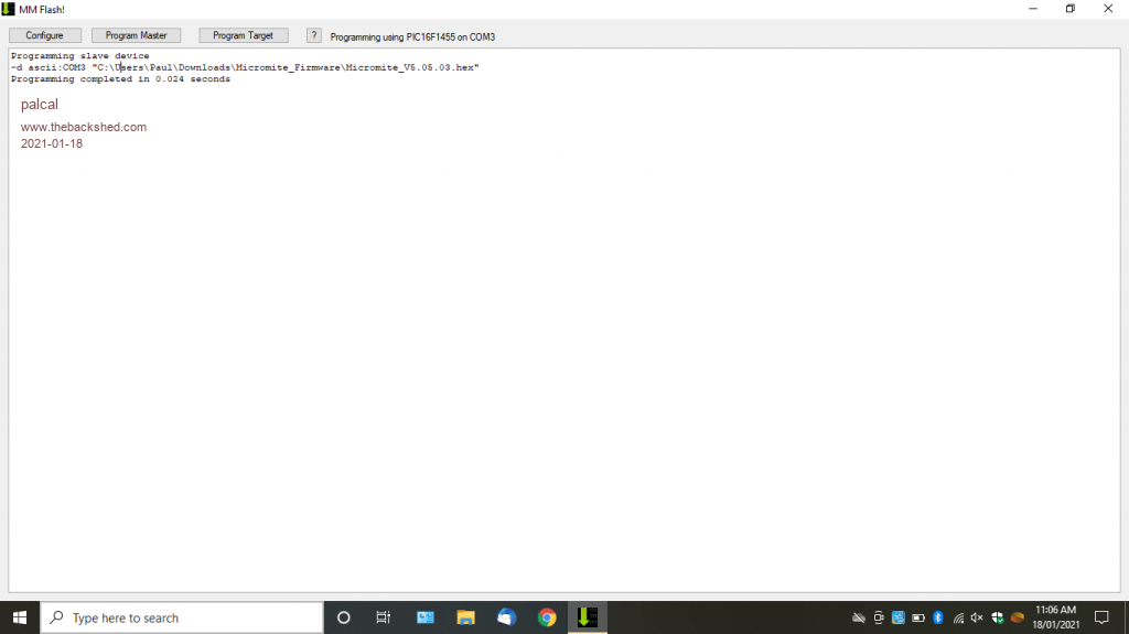

         I am trying to flash a chip, but can't figure this out. 'Program Master'
mentions Arduino and seems to do nothing while "Program Target" takes me to my Hex files, I select a file and MM.Flash tells me it is programming via 1455 ver. 5.05.03 in .006 seconds. I am obviosly doing it wrong. This is an a Windoze Mach.
         I normally use Robert Rozees 'PicProg GUI', too easy, but I want to see if I can flash a chip on Linux and with 'PICProg GUI' I cant select the USB port.

Program Master will program the Arduino nano with Robs firmware.
You only do that once if you keep a dedicated nano for programming.
Then program target will send the MMBasic firmware to the MM chip via the Arduino
If you are using a PIC1455 that is already programmed, you don't have to do the program master step.
I don't know what success you will have under Wine.

I think I understand it now, I am programming through the 1455. Don't know why I need the PGC and PGD pins, I thought the 1455 would take care of that.
It seems to work, runs through everything and says it programmed but it only takes a fraction of a second and does not program the chip. I don't think I will bother with it, don't know if it will work on Linux anyway but it seems to do the same as on Windows. If I have to use Windows to flash the chips so be it.
This is what MM.Flash says

I also receive this file.
  Quote  [Windows]

Posts: 6606
Posted: 02:39am 18 Jan 2021
That file is just the settings that get remembered between sessions.
If you delete it, the default settings get used next to.
MMFlash and Rob's GUI are both wrappers for the commandline tool so if one doesn't work under Wine, it is most likely that the other one won't work either.
