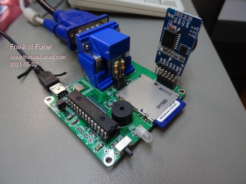

Yes, I ordered that connector from Mouser back then, too. It was relatively expensive (significantly more than a standard VGA and two PS/2 connectors would have cost). It’s only worth ordering from Mouser if you exceed the magic €50 threshold - then you don’t pay shipping costs, which otherwise amount to €20 on their own. On the other hand, Mouser doesn’t charge a minimum order fee - only a mischievous person would think ill of that...
Still, it's a pretty nice little device and a lot of fun to use! It's really annoying that the .lsl command doesn't work anymore. It was very helpful to list the internal libraries...
Unfortunately, I don't have a GitHub account - maybe someone could bring the issues I've listed to Knivd's attention?

Frank N. Furter
Joined: 28/05/2012
Posts: 1143
Posted: 02:16pm 14 Apr 2026
@knivd:
Unfortunately, the new version isn't working properly:
- ELLO does not start when the SD card is inserted.
- The .lsl command still isn't working
- I can't get any of my old programs to run anymore. After typing .=, nothing happens at all...   Loading the programs seems to be working...
.n without a number no longer renders the device unusable
Frank

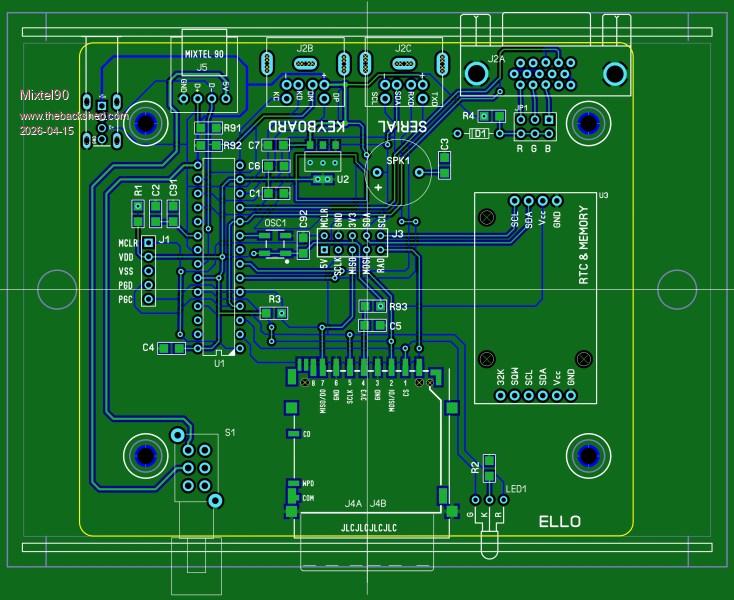

I couldn't resist...
I went back to my version of the board and scrapped it. I realized that there's nothing to be gained by jamming everything into a small space when you need a VGA monitor and PS2 keyboard to do anything, so I changed it to fit the cheap Hammond enclosure. You can still use it as a stand-alone open PCB, it's just bigger. :) It costs the same to order five of either size.
I've made the following changes to knivd's design:
Complete re-size and re-layout
Split J2 into separate sockets
Included the RTC
Changed the USB connection to USB-C (including space for pull-down resistors)
Added a USB-A connector to avoid needing a splitter on the keyboard socket
Changed the SD card to full size & added a filter resistor
Changed the regulator
Made the power switch a true on/off button
Made small components SMD (but only 1206 so not that bad)
Some of the changes are only because I either have the bits already or they are easier to get and many people may already have them. Nothing technical. :) The component references are generally as knivd's ELLO 1A design, I've only made very minor additions which can be left off (9x references are mine).
All untested other than going over it in SL6, of course.  :)
Gerbers etc. soon if anyone wants them.
