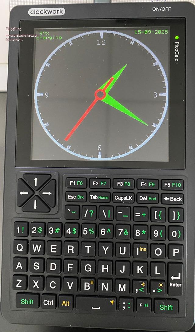

Andrew_G
Joined: 18/10/2016
Posts: 907
Posted: 05:50am 02 Jul 2022
Hi all,
I needed an analogue clock with a face etc so I fiddled with Peter's code and came up with the following. (it will form part of a larger Weather Station program).
Cheers,
Andrew

Andrew_G
Joined: 18/10/2016
Posts: 907
Posted: 05:57am 02 Jul 2022
Here is how it looks.
{Edit: I've just noticed that my LCD is not centered. A -3 reduction in the ana.X and ana.r fixes it. YMMV}
Edited 2022-07-02 16:40 by Andrew_G
PilotPirx
Joined: 03/11/2020
Posts: 164
Posted: 11:33am 15 Sep 2025
Works on my PicoCalc too!
