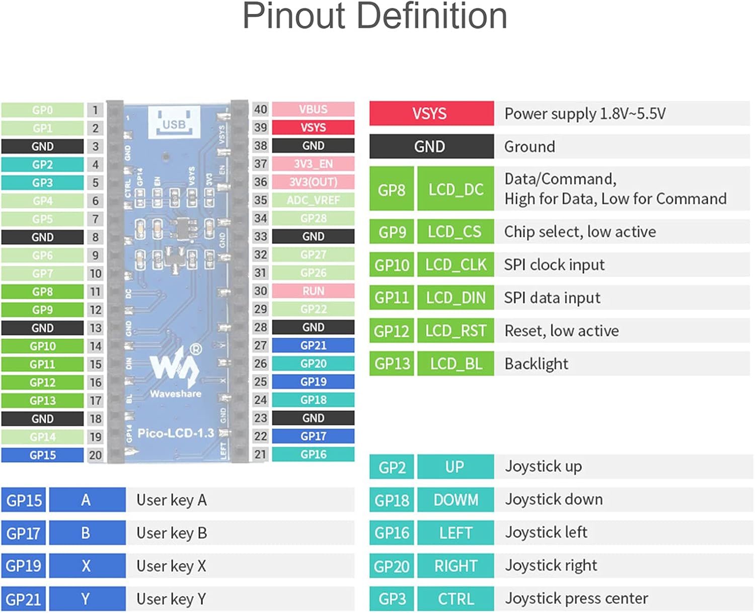

The OPTION SYSTEM SPI calls for CLOCK, MOSI, MISO
I (almost) have :
Note no MISO or RX et. al.
Anything I put for MISO that will stick conflicts with OPTION LCDPANEL ????
How can I put a null or ????

Which LCD panel are you using?
Mine simply uses the system SPI, its other pins can be assigned to any free Pico pins.

Now your problem is clear. To use PicoMite firmware an adapter board may need to be made to re-arrange the pins.

  Quote  Anything I put for MISO that will stick conflicts with OPTION LCDPANEL ????
GP28

How did You arrive at that ?
