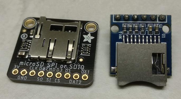

... attached to the cheap SPI LCDs such as the one used on the PicoMite backpack c.f. those on the little MicroSD reader modules ?
Are they within the metal casing, or am I making sh*t up?
Note I'm not talking about the troublesome inline resistors on those same LCD displays, I've bought some 0R SMDs to deal with those blighters.

You don't need or really want pullups for SPI. You do need them for SDIO depending on the weak pullups available in a particular processor

  matherp said  You don't need or really want pullups for SPI. You do need them for SDIO depending on the weak pullups available in a particular processor
OK, thanks Peter, still trying to get my head around this since you said SD card adapters with resistors are bad and then recommend the one on the left for the VGA PicoMite.
But I now (hopefully) understand that it's the inline resistors that you object to and those on these adapters are pull-ups.
I'm correct in thinking that the capacitors on both these boards are the "decoupling capacitors" such as the 10uF and 0.1uF I might see on a breadboard an IC?

The pullup resistors on the adafruit adapter are 47K. This is correct for SDIO and irrelevant for SPI. Many boards have much lower values which is just wrong in all cases
