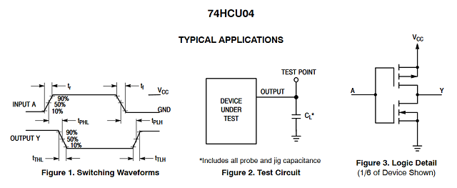

i'm following the suggested design put forward in the first post of this thread:
https://www.eevblog.com/forum/metrology/an-experimental-pwm-circuit-with-74hcu04/msg3921608/#msg3921608
there have been various discussions over the years about paralleling up CMOS gates to achieve the equivalent of a pair of closely coupled MOSFETs switching between supply rails. the onsemi datasheet for the 74hcu04 confirms:
(retrieved from: http://pdf-html.ic37.com/pdf_file_A/20200531/pdf_pdf/pdf4/ONSEMI/74HCU04_datasheet_830450/135209/74HCU04_datasheet.pdf)
you are 100% right, i need the full 5 volt drive on the PWM signal going into the 74HCU04. this explains a 0.15v low level output i was seeing when the PWM signal was driven high. will try convering the PWM to 5v levels this evening and see how it looks.

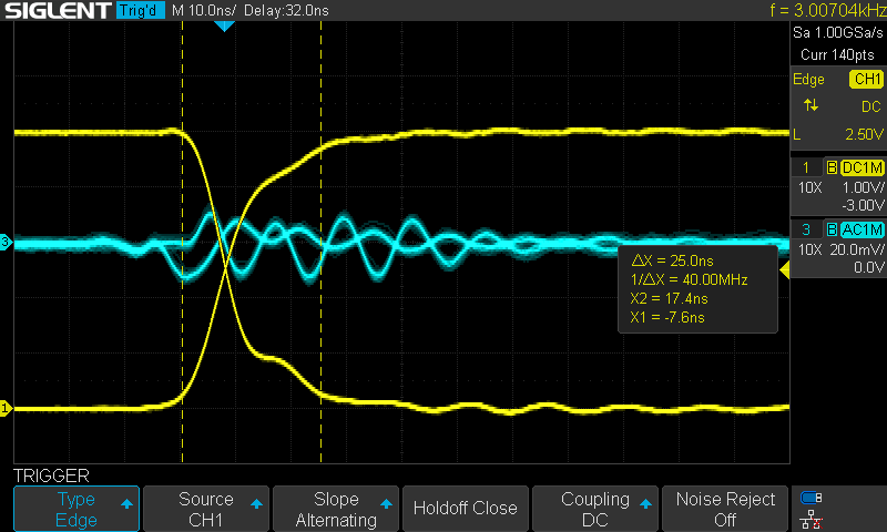

Posts: 2542
Posted: 11:45am 24 Feb 2022
  Volhout said
The accuracy of the duty cycle is determined by the resolution of the PWM, but also the delays in the switch (74HCU04) and the level shifter.
The transistor level shifter (BC547 and 2 resistors) is relatively slow and highly a-symmetrical in delay (the output high-low is MUCH faster that low-high). Good for an experiment, but not suited for the final product.
As much ridiculous  as it may look, I would build a chain.
MX170 -- 1xACT04 buffer -- 5xACT buffer -- 6x HCU switch -- RC filter
good point, i had been hoping that the BC547 + 4k7 would be 'just good enough' for the job     this evening i tested a slightly simpler approach, reconfiguring the 74HCU04 as a single gate at the input end, that then driving into the remaining five. the BC547 et al are now eliminated, and the output at the 5x paralleled outputs looks like this:
the cursors (dotted vertical lines) are set 25ns apart, or the equivalent of one 40MHz CPU clock cycle of the micromite. as can be seen (yellow trace), both the high-low and low-high transitions now complete within this time interval, and are fairly closely matched in slope. the result is better than i expected!
the blue trace (AC coupled) shows ripple of 30mv or so on the reference output at each transition. note that both scope channels are set to 20MHz bandwidth limiting. my shoddy solderless breadboard assembly with long jumper wires is an RF nightmare.
