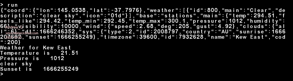

Posted: 04:11am 20 Oct 2022
Hello all,
I hope this is the correct place to ask these question as this thread seems to have gone cold but:
1) Is there a problem with JSON on MMB4W?
I have MMB4W 5.7.03 (the latest?) and I'm using Peters code above "Posted: 02:04am 26 Feb 2022" but with my APIKEY and my place ID.
At the end I've added:
Print "Sunset= ", json$(m%(),"sunset")
expecting to get the EPOCH number of the sunset time.
It runs (very quickly), I get everything else printed but I only get blank for the sunset time.
Similarly, for most of the other parameters (I've tried almost all, including from the command line etc) I only get blank (and no error messages).
I've also re-keyed Peter's statements and they work.
Has Peter managed to pick the working ones or am I doing something very wrong?
2) Is there a newer version of MMB4W?
3) Is there a newer release of the manual.
4) the TCP command makes it so easy to access the web from a PC - is there any possibility of a similar one on the PicoMite (albeit with some LAN connector?) (the ESP8266 is a poor second in my view).
Many thanks,
Andrew
Posts: 6549
Posted: 05:56am 20 Oct 2022
  Quote  Print "Sunset= ", json$(m%(),"sunset")
Print "Sunset= ", json$(m%(),"sys.sunset")
Difficult to see without formatting the string but you need the "sys" prefix.
Andrew_G
Joined: 18/10/2016
Posts: 883
Posted: 06:24am 20 Oct 2022
Thanks Jim,
Yes that did it!
I was about to ask why but I now see that it is within the sys brackets { } and "name" "Kew East" are outside it so don't need the sys. OpenWeather/JSON 101.
Any thoughts on my other three questions?
Cheers,
Andrew
Here is the output after I added the "sys."
