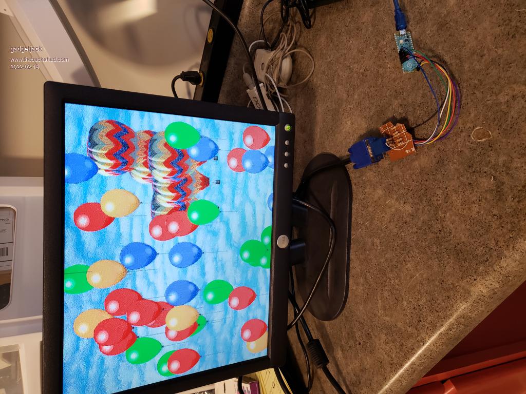

I found this code on https://github.com/Panda381/Pico16VGA. Very simple circuit with lots of sample programs, all drag and drop to load. I have only went through about 4 of the samples but they look pretty good. All 640x480 in 16 colors. He has other works on his page , but have not tried them all yet. Some good stuff for a cold winter day.

Uses too much RAM I suspect.
Posts: 8981
Posted: 06:19pm 18 Feb 2022
Correct. He used a large percentage of the Pico#s RAM for a frame buffer with a small program space. You can't have both. Clever stuff, but not of practical use.
