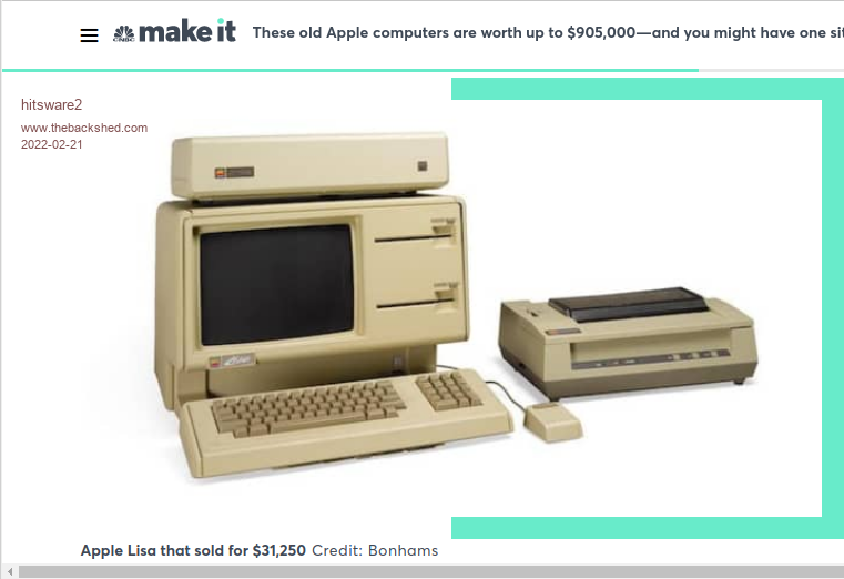

hitsware2
Joined: 03/08/2019
Posts: 738
Posted: 01:03am 21 Feb 2022
my site

A lot of the old computers are very collectable.
