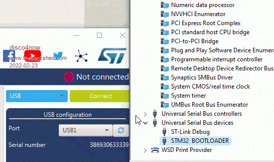

Just to confirm:
You have BT1 connected to 3.3v when power is applied to get it into bootloader mode.
Do you see the STM32 BOOTLOADER entry under Universal Serial Bus Devices in Device Manager.
Is it windows 10 or something else ?  WIN7 needs a driver loaded.
If BOOTLOADER thing is there you should select USB in STM32CubeProgrammer and then hit the refresh icon to find the port.
Normally BT0 to GND is not required but I remember one case where it was also required.
I think it is also possible to program via the serial port if you can't get usb to go. (You would need a USB to serial adapter).
Maybe try a different USB (known good) cable to rule that out.
