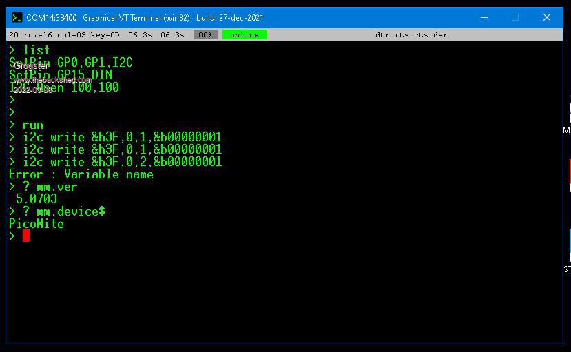

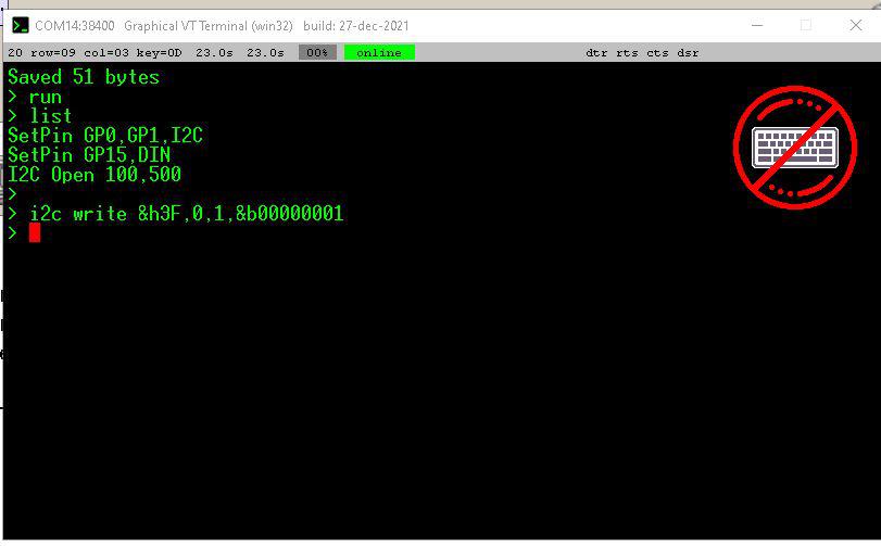

I still consider myself a novice where I2C is concerned, so I may well be doing something obviously wrong.
However, when I setup I2C, when I try to send a byte to an I2C slave, all that is ever sent, APPEARS to be the address byte.
My simple testing code.  Set the IC2 pins, open the port.
At the command prompt, I am then experimenting - should I not be doing THIS perhaps?
IE: All I2C commands need to be inside the code?
Anyway, on to the next image:

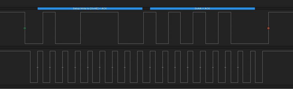

The logic analyzer on the GP0 and GP1 I/O pins only seems to reflect ONE byte, even though I am trying to send TECHNICALLY two bytes - the address and the data byte.
I did not think you needed to count the address byte as part of the payload.
Do I have that wrong?
EDIT: Image is a little fuzzy - White-on-blue decoder info says "Setup Write to (~) + NAK"  Parenthesis uses instead of square brackets, as they are forum formatting flags, but they are square brackets in the image.
I tried that also here:
....but I got an error message(Variable name), which suggests that what I was doing originally was correct in terms of command formatting.
If I ? MM.I2C, it replies with 1 - NACK.
The I2C slave address IS correct according to the manual.

Check mm.i2c. You are almost certainly getting a timeout. i.e. the Picomite isn't seeing the ack from the slave so times out rather than sending the second byte.

Can someone confirm that the logic analyzer output IS the correct address?
As it seems that the address byte is all that is ever being sent.
I could believe that, if the slave never acknowledges....
But I want to know if the logic analyzer output is indeed a byte of 3F.
EDIT: Increased the timeout to 500mS - still exactly the same.  It's like the slave chip simply isn't responding at all.  I still need confirmation of the address byte as being 3F....

Page 5 of THIS PDF gives read, write and 7-bit addresses(without the R/W bit), so it is suggesting that with A0,A1,A2 all high, the slave address is &H27 - totally different to what the TE PDF says for the same part.  Confusing.
I will try with an address of &H27 and see if we get talkies.
Posts: 10039
Posted: 10:44pm 08 Mar 2022
WORKING!
Slave address(7-bit) is indeed &h27.
EDIT: The NXP datasheet is FAR superior to the TE one.  The TE one only gives you very minimal information, really.  As soon as a downloaded and started reading the NXP one, I could immediately see some new things to try, prompted by Volhout mentioning there are two different slave address ranges for this chip, depending on which one you have.  The TE one only talks about the A variant and not the non-A variant, so no wonder I could not make it work, as I had no idea at all, that there could be another variant with a different slave address range....

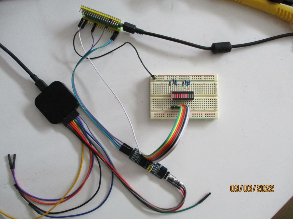

Thanks, Grogs. Here are two PCF8574s toggling LEDs: PCF8574 output to LEDs
Dim integer k1=&b10101010,k2=&b01010101
 I2C write &h38,0,1,k1: I2C write &h39,0,1,k2: Pause 500
 I2C write &h38,0,1,k2: I2C write &h39,0,1,k1: Pause 500
 If Inkey$<>"" Then Exit
I2C write &h38,0,1,255: I2C write &h39,0,1,255 ' turn off
FCF8574s use negative logic, so writing a "1" turns a bit off and writing a "0" turns it on.
