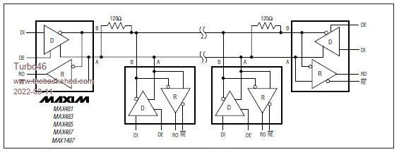

Yes, it does seem that R5485 is not what you want. 4-wire RS422 is more like it. The problem then is collision avoidance and/or handling when two or more nodes want to talk at the same time.
Unless you can poll each node rapidly and they respond with a NACK or data as appropriate? If you get the NACK at least you know the node is still active and it does avoid collisions.

A simpler possibility is for the nodes to actually be slaves. They are periodically scanned by the master and a 2-byte message triggers an interrupt on them. They read this, the first byte is a slave address, the second is a command. If addressed, they respond with a single status byte. That contains a flag if the slave needs attention. The master will then, serially, scan each slave with the attention flag set and deal with it. After the slaves have been handled the master goes back to scanning the status flags again. Or something along those lines anyway. It probably takes more time to explain than to do. RS485 can be pretty fast. :)

Multiple RS485 slaves are usually daisy chained. Looped from one to the other to the next with a terminating resistor at each end. Not passed through and forwarded on so if one fails the rest should still work (unless it goes short circuit). If you use a connector like the one below to loop in and out of you can unplug one without affecting the others (timeouts and retries aside).

RS485 is typically used in installations, and is not per-say hot swappable.
The bus can have multiple devices on it, but general way of installing is that there is a termination of 100-120 ohm at both ends of the bus. In many cases this is at the controller, and the most remote slave.
Slaves in between (these must have the termination disabled) could be removed or added...but.... The controller software must be able to cope with this. The protocol is a dialog where the master asks the slave for response, or orders it to perform tasks. Timeouts can be added, but while waiting for the slave to respond the bus is typically idle. So removing a slave can slow down the system significantly.
Adding slaves, the master must scan the bus (including timeouts when there is not reponse) for new devices.
Hotplugging is technically possible for all but the outermost RS485 devices that terminate the bus (or you have to add separate termination, and disable all terminations on devices)

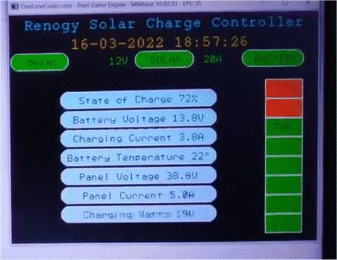

While awaiting my RS485-to-ttl modules and an order of 8AWG solar cable, lugs, and Anderson connectors, I decided to write a display and emulator for the Renogy 20A Solar Charger. The PDF link is on this github site:
Renogy MODBUS pdf
I haven't done much so far with MMB4W, so thought this would be a good little test of it, with one MMBasic program emulating the Renogy device as MODBUS server, and another as MODBUS client displaying the data.
Two sessions of MMB4W worked very well for this. Instead of RS485, the client wrote a file containing the MODBUS message, and the server read it and responded by writing another file with the MODBUS response.
MMB4W made this very easy. I edited the two files in Notepad++, and issued a LOAD for the program and then a RUN. When a program errored out (or I terminated with <ctrl-C>), I edited and saved the code in Notepad++, and then back in the MMB4W window, pushed up arrow twice and <Enter> to reload, and up-arrow twice and <Enter> to run. Easy-peasy.
Here's a youtube video, with the simulation starting with the battery fully discharged (which I'm calling 12V). The charge level indicator on the right turns from red to green (indicating level of charge) in 8 steps. When fully charged, the sun goes down (effectively), and the battery discharges. When fully discharged, the battery indicator background goes from green to red. When the sun comes up, the battery starts recharging.
Renogy Solar Charge Controller Display Simulation (Sorry for the annoying wiggle.)
Here's the server (Renogy) code:
