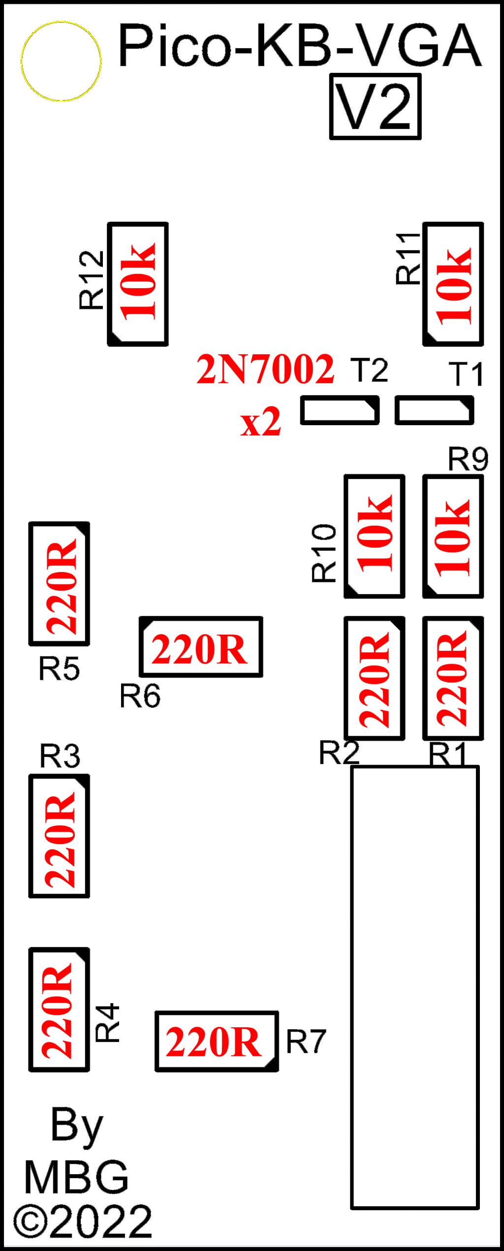

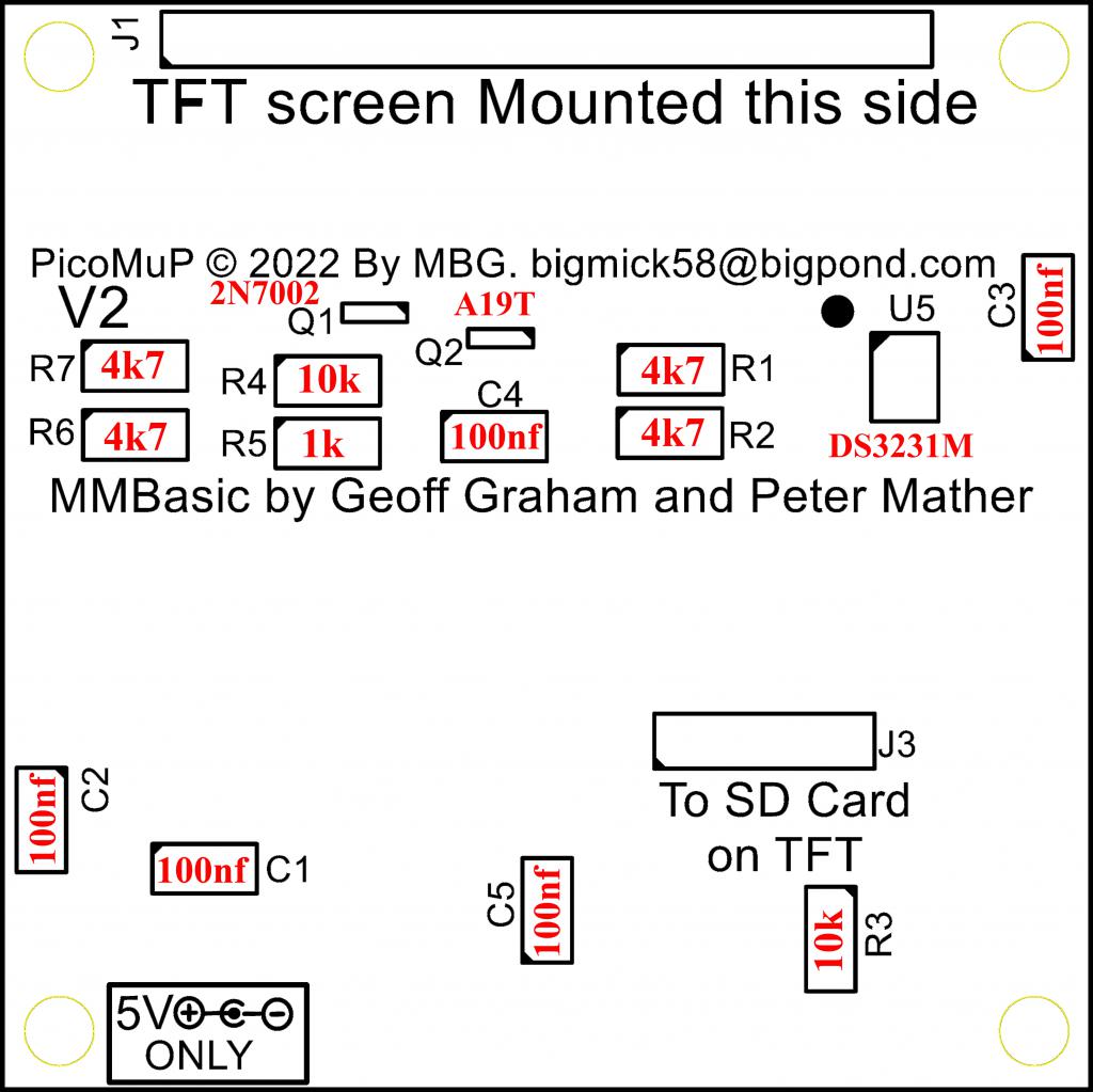

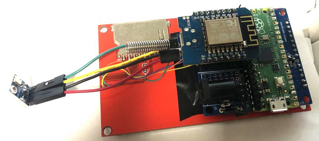

Hi Plasma,

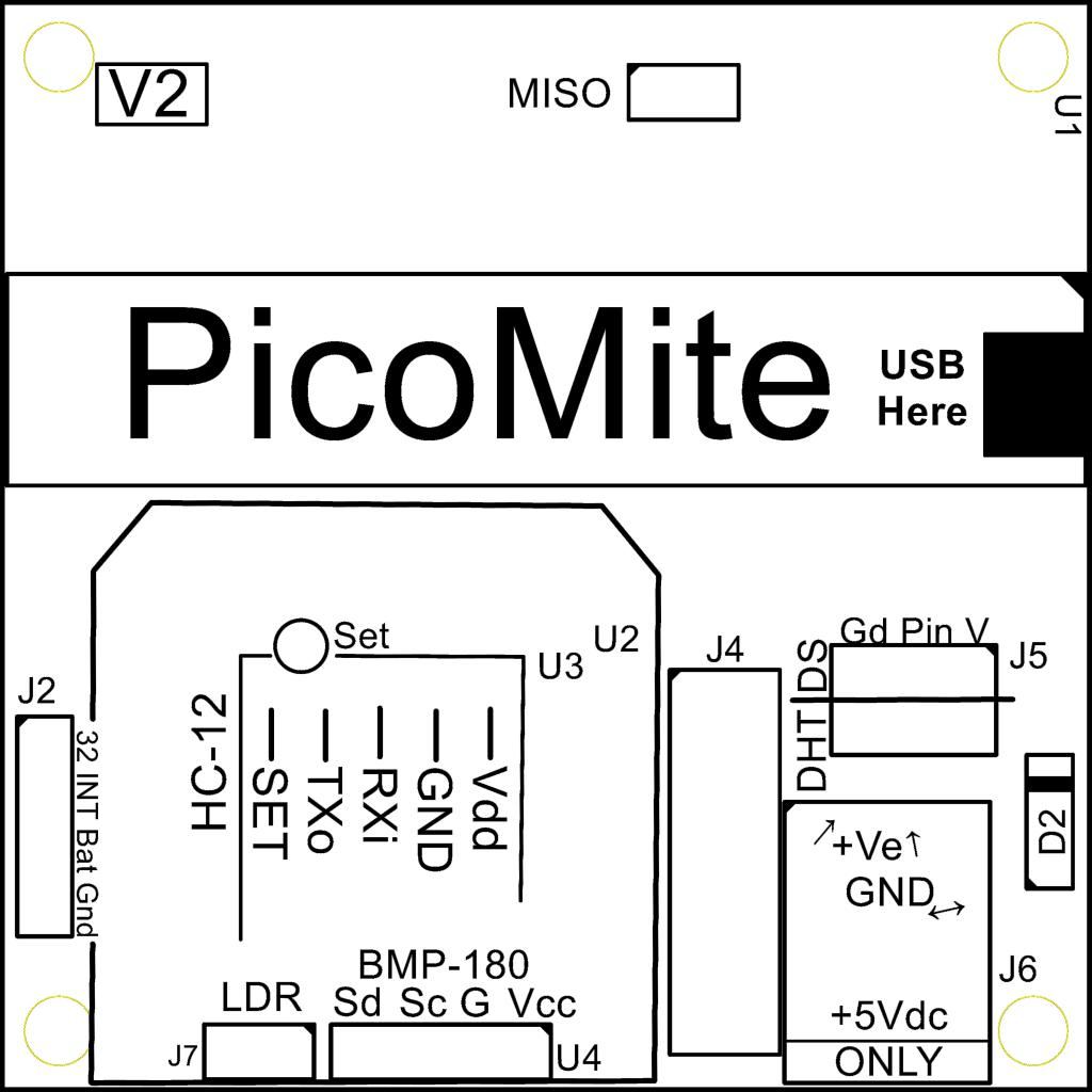

Or my one, About to be released? Here is a quick Picture.
The PCB is 50mm x 50mm
Has support for an on board ESP8266-Mini
Has support for an on board HC-12 (you can see the antenna poking out (the HC-12 is mounted under the ESP-8266-Mini)
Has support for a BMP180 (on the 4 flying wires)
can use the TFT onboard SD card (the 4 skinny wires, you could use headers and wire jumpers if you prefer.
Support for TFT 14pin SPI with touch and Backlight control
Barrel jack for 5Vdc input (or the USB as a power source)
A header for DHT-22 (This is on the 2x3 header you can see to the right of the barrel jack)
A header for a DS18B20 (This is on the 2x3 header you can see to the right of the barrel jack)

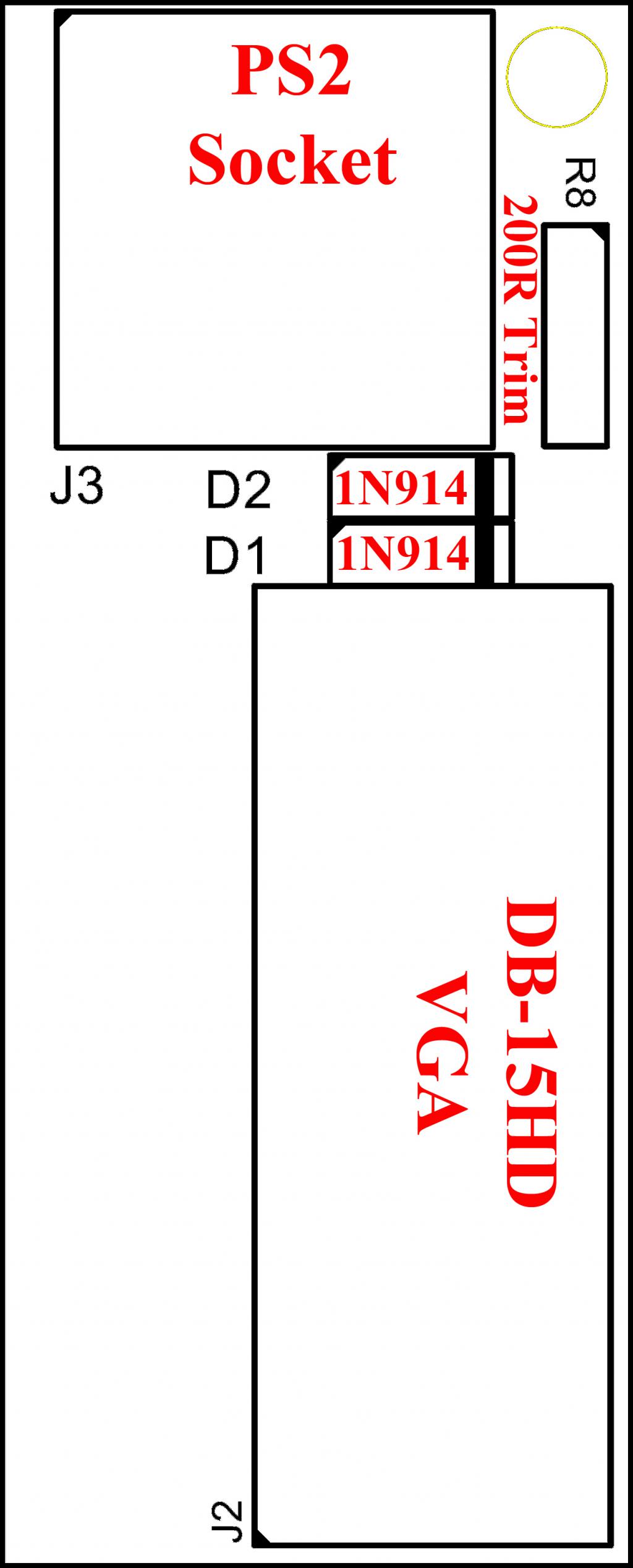

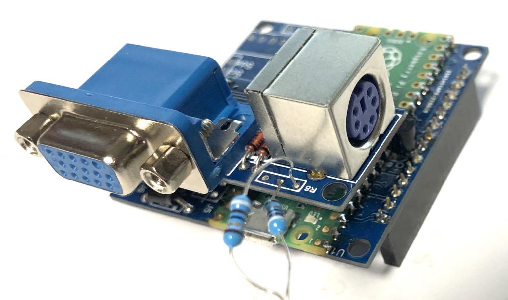

A 2 x 7 pin header to go to a daughter PCB that has PS2 and VGA. (In the picture below I have 2 resistors, to determine the value for the second Green as I didnt have a 200R timpot)
All these pictures are of the Ver 1 board which has some minor issues, I have some Ver 2 boards if there is interest but I havent done a manual as of yet but I do have Shematic and Overlays,
Hey I can add them here. No schematic of the PS2 and VGA but it is the circuit from the manual.

Posted: 11:10am 14 Jul 2022
Hi Mick (the other one), All,
Firstly I apologise for the huge pictures, I should have reduced them first.
I do think I squeezed in a lot on the small board,
Of course you don’t need to have everything optioned on your build, it’s just that they are catered for if you want/need them.
My goal is to create a tiny Pico-PC using these boards and my tiny box arrived toda6 and it looks like it will be a goer. Unfortunately it will mean soldering the boards together as the heights required mean standard headers will be too high to fit.
I have another board I am nearly finished that will give the Audio (as per the manual) plus a 20way (2x10) R/A header that will still fit the form and (once again directly soldered) and squeeze between the main board and VGA board and, hopefully still squeeze into my tiny box.
The box itself? I hear you ask, is 56mm x 58mm x 28mm (draw it out it IS tiny) externally so it will be tight but I think it will be doable.
If it works out it will be a miracle.
