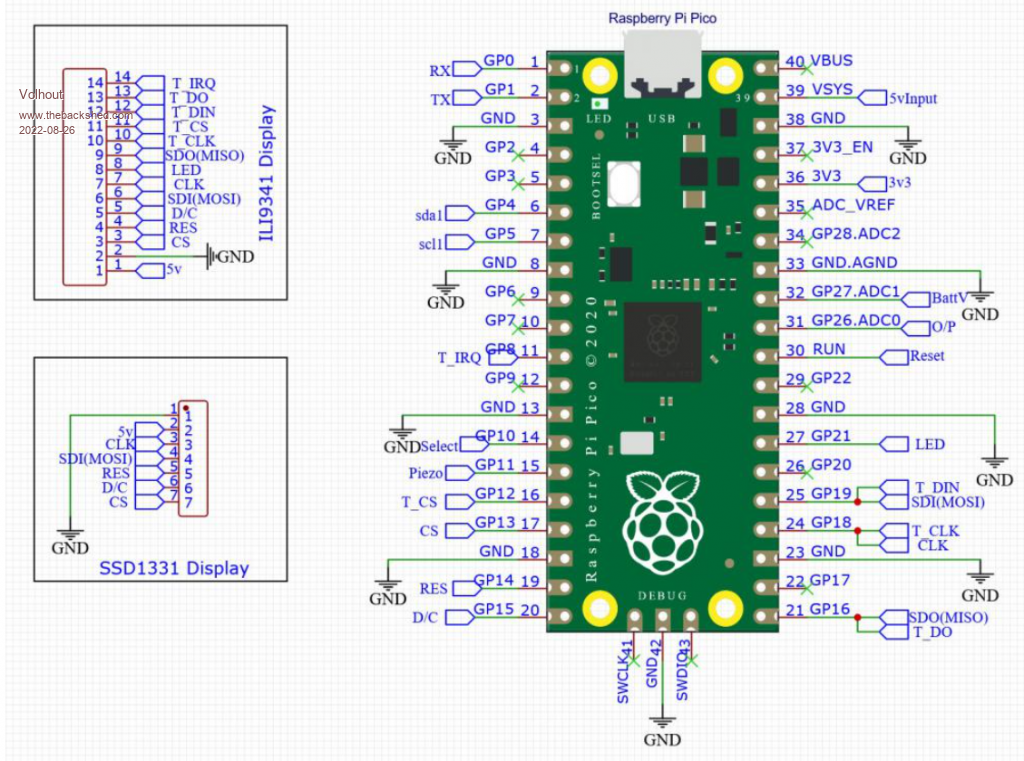

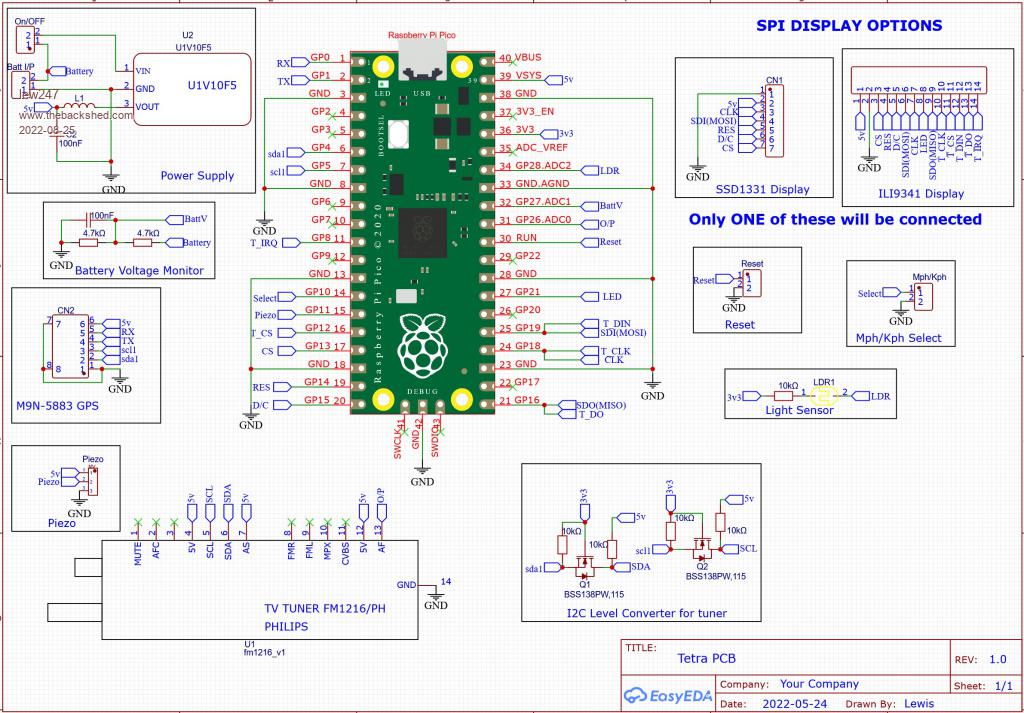

The manual says SETPIN rx, tx, COM1 which should in this case be GP1, GP0?
I tried both SetPin GP0, GP1, COM1 and SetPin GP1, GP0, COM1 and went through all the baud rates but nothing on the console/
I'll leave it running for a few hours in case it only shows data once it has a valid lock

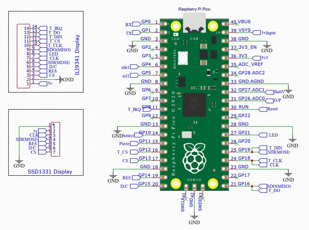

Hi Lewis,
This should be your option configuration for touch and display
'OPTION LCDPANEL ILI9341, OR, DC, RESET, CS
OPTION LCDPANEL ILI9341, "L",GP15,GP14,GP13
'OPTION SYSTEM SPI CLK,MOSI,MISO
OPTION SYSTEM SPI GP18, GP19, GP16
'OPTION TOUCH T_CS,T_IRQ
OPTION TOUCH GP12, GP8

from the picomite manual page 47 for ili9341
OPTION SDCARD GP22
OPTION LCDPANEL ILI9341, L, GP15, GP14, GP13
OPTION TOUCH GP12, GP11
I followed the manual and touch gp12,gp11 not gp12,gp8
The manual circuit and set up works.
The sd card seems to use spi but the cs line gp22. is it software or hardware?
can I use gp2 ,gp3,gp4,gp5 for I2C when using ili9341 using the manual circuit and setup please?

On the PicoMite SPI chanels CS is always handled by MMBasic, not in hardware. You can specify any pin for CS.
The I2C channels, even though they can be allocated to the same pins as SPI channels, are separate devices so yes, you can use I2C on any other suitable pins as well as having SPI devices connected.
When using a ILI9341 it's normal to connect the display, touch controller and SD card to the same SPI. They have individual CS lines so there is no conflict.

Hi Lewis,
I have done a minimal wire up of my identical M9N-5883 GPS to the PicoMite and it seems fine - note that you don't need a lock for this to write output to the console.
Open "COM1:115200" As Gps, 0, 1
 Pause 100
The correct wiring is
GPS     | Pico
5V      | 40 / VBus
TX      |  1 / GP0
RX      |  2 / GP1
Gnd     | 38 / Gnd
The best guess of this ignoramus is that (excluding any release of the magic smoke) you have TX-TX and RX-RX connected directly instead of crossed TX-RX, RX-TX. This argument is strengthened by the fact that in the diagrams of the Pico posted earlier you have GP0 labeled RX and GP1 labeled TX ... they are in reality the other way round ... though you may have labeled them according to what they are connecting to rather than what they are ???

Posted: 07:26am 26 Aug 2022
Thanks Tom
I had an issue with the GPS receiver, the soldering I had done to connect it was that bad it was joining 2 tracks
Once I sorted that out this morning it "seems" to be receiving properly now, I'm using the Ublox program to make certain the GPS is functioning properly before moving back to the Pico again

Posts: 6107
Posted: 07:30am 26 Aug 2022
  stanleyella said  from the picomite manual page 47 for ili9341
OPTION SDCARD GP22
Look at the schematic presented earlier. Lew247 has done it's own design.
Posts: 3379
Posted: 07:35am 26 Aug 2022
From the pin diagram on p 9 of the manual
PWM0A COM1 TX I2C SDA SPI RX GP0 1
PWM0B COM1 RX I2C SCL GP1 2
So  Pico pin 1, GP0 is Tx - output
and Pico pin 2, GP1 is Rx - input
It would seem the circuit at the start of this thread is labeled for the destinations of the pins, not the pin function.
Diagrams that have actual wires are less confusing.
Posts: 9132
Posted: 07:53am 26 Aug 2022
Specifying GPn pins - never pin numbers - is the best way. That way a design is transferable to any of the Pico clones without modification, no matter how many pins it has or how they are arranged. Showing pin wiring diagrams is pretty but is only applicable to that one model of RP2040-based device.
Obviously, this can get a bit out of hand, but if you look at the circuit drawings I produce for my PCBs, you'll see that each "circuit module" is labelled with GPn destinations and the Pico is shown separately. It would be trivial to convert those drawings for *any* RP2040-based module.
