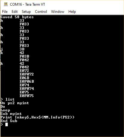

As an experiment I've implemented a Basic interrupt triggered by raw PS2 codes.
PicoMiteVGA.zip
This allows you to manage keydown and keyup events. Let me know if this is useful. See https://wiki.osdev.org/PS/2_Keyboard for the scan codes (Set 2). I haven't implemented print screen pressed , print screen released, pause pressed , pause released for obvious reasons

Thank you Peter,
after a Quick test
works fine, gets Keys like Right Shift/ctrl/Alt Left Shift/ctrl/AltGr
Repeat is still there (Cause of the Keyboard electronic) but stops sending as soon as the Key is released.
@Harm
no, only one key press is reported, so you dont get a "Mixed result" if more than one key is Pressed at once.
Will test it further.
