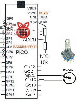

Hey, I have again a new problem.
Now with Encoder.
I did nor get pin 19 and pin 20 to go 3.3V
I added 10k resistors from both to 3.3V.
Now I got 3.3V, but it doesn't start the Inter sub program, when I connect Encoder signals to ground.
Can somebody help me?

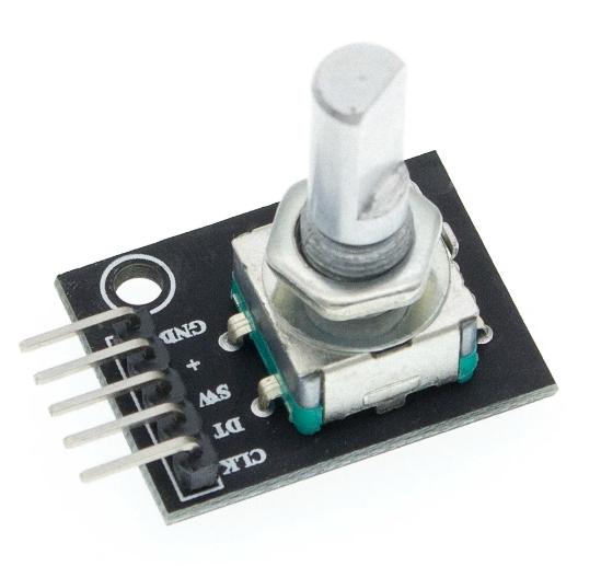

Is that a rotary encoder or a potentiometer? The rotary encoder modules I've used have had 5 pins.

Hey Lizby.
I have only two contact to ground. one to left the other to right.
I have got it worked in CCS c-language, but now I do not get the pins to ground,
although my multi meter shows ground.

Posts: 6603
Posted: 08:22pm 03 Nov 2022
PIN 19 is not the same as pin GP19
You can use the physical pin numbers (pin 25 and 26) or GP19 and GP20
If you have external pullups, you don't need the PULLUP option but that shouldn't matter.

Posts: 3879
Posted: 10:58pm 03 Nov 2022
These are the rotary encoder modules I have used, which work perfectly with Peter's code.

Posts: 6603
Posted: 01:43am 04 Nov 2022
Using your existing circuit, this program should run
(adapted form code written in 2014)
' simple encoder reading TassyJim Nov 2022
 SETPIN gp19, DIN, PULLUP' setup RB as an input
 SETPIN gp20, INTH, RInt, PULLUP' setup an interrupt when RA goes high
 DO
   ' < main body of the program >
 LOOP
SUB RInt ' Interrupt to decode the encoder output
 IF PIN(gp19) = 1 THEN
   Value = Value + 1 ' clockwise rotation
 ELSE
   Value = Value - 1 ' anti clockwise rotation
 ENDIF
 PRINT Value
END SUB
I tested without any external pullups and small capacitors (0.1uF) on both switch lines as debounce.

Posts: 9128
Posted: 07:35am 04 Nov 2022
IIRC, lizby, those have pull-ups to + from clk, dat & Sw. All three are then pulled down when active. It's a simple wiper-type encoder, not optical. It's easy to check - an active encoder will have both VCC and GND to the encoder itself, as well as anything else. These are actually 4-wires: clk, dat, sw & common.

oh3gdo
Joined: 18/11/2021
Location: Finland
Posts: 47
Posted: 10:53am 04 Nov 2022
atmega8
Thank you.
When I loaded your program, it doesn't work.
I checked my circuit and found that I have once mode put my wires one down.
When corrected the numbers right PIN 18 and PIN 19, the circuit works find!
Thank you.
