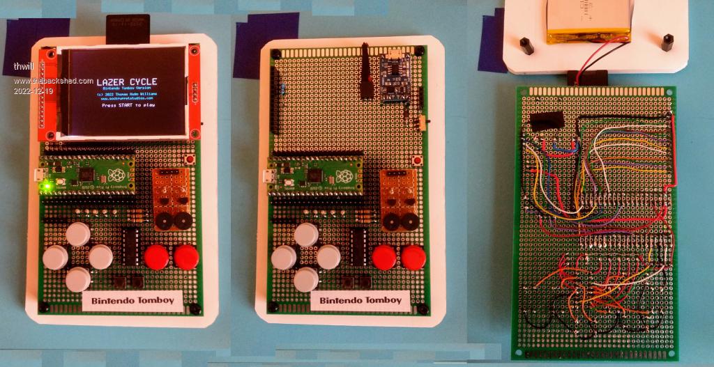

What a busy board, I'm gratified my little project and naive questions are providing some entertainment. Hey Mick, many thanks for the offer, but I was rather hoping to do it myself, and if that fails then UK-spec Mick has rather beaten us both to it .Ha, "sell" , this is just a bit of play and I'm happy (maybe with some trademark quiet grumbling) for anyone to do what they like with it. I think as a hobbyist the sign of "success" for me in electronics hardware would be some Chinese chap{ess} knocking off something I've done, preferably whilst keeping (but misspelling) my name on the PCB silk-screen.Thanks Bill, that was one of the sites I had identified as "not entirely reliable looking". I see now (and from UK-spec Mick's comments) that it isn't a "complete solution", so probably not what I am looking for. I actually knew that, or knew enough to be able to look it up. My comment was mostly in jest; though seriously every design @Volhout does seems to require different capacitors. P.S. I have received your email about the adventure assembler manual and given it a brief scan, will try and comment by the end of the week. Hi Phil, I found an EDA forum comment that that is explicity not what it is (though there was the suggestion they used to do it like that in EasyEDA), apparently it is the approximate distance in inches between the pads, though who measures inches in decimal fractions, surely they should be in 16ths ? I'm not terribly impressed by the documentation for EasyEDA. Thanks Mick, I always find some of the best advice you can get is when someone devoted to a given tool tells you not to use it . I'm coming around to the idea of investigating KiCad, it sounds like my sort of thing being open-source and with actual (dead-tree) books written about how to use it.Very pretty, and as I suspected, knocked out of the field faster than I can blink, though I probably won't be building one myself until my own efforts fail. In the meantime here are some comments and questions: - What is OR22 for ? it's at the top of the filter section, I assume that means it's 0.22 ohm? - I vaguely think @matherp has answered this for me before. - You've got 22nF capacitors in the filter section, assuming you are copying Volhout's design should they not be 33nF ? - What is with the 3K3 and 6K8 resistors between filter and amp, where did they come from ? - I assume that is an (unlabeled) 10K resistor pack on the controller board ? - What is the transistor and resistor on the controller board for ? - YMMV, but I'm not sure there is much point having a "full sized" SD card on the PCB given the ILI9341 modules all seem to come with an integral one. No objections from me, though if anyone in the UK does have a batch made up I wouldn't mind receiving one for posterity. Best wishes, Tom Edited 2022-12-22 21:07 by thwill MMBasic for Linux, Game*Mite, CMM2 Welcome Tape, Creaky old text adventures |

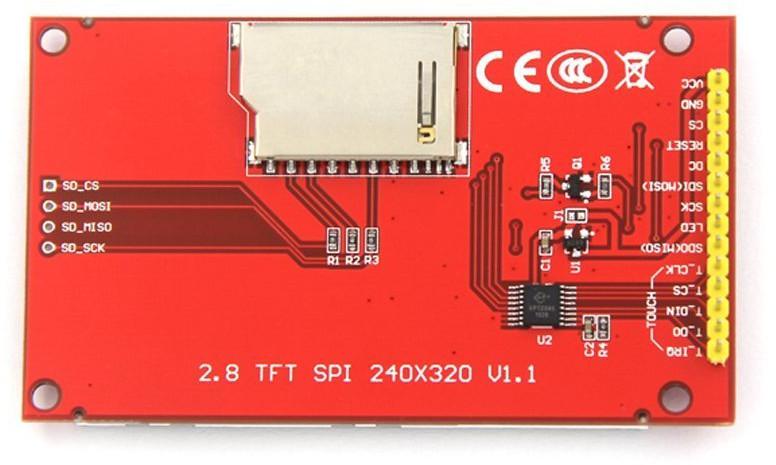

Hi folks, By (lack of) popular demand here is a schematic (it may contain mistakes): ![]() Or as a better quality PDF: bintendo-lameboy-mk1-0.1.pdf It's the first schematic I've done of any significance and having no formal training I've basically made it up as I go along based upon the tooling and what I've picked up by osmosis. I'd appreciate comments on the format of the schematic particularly (and the design itself if you like, but that's less important). Particular questions that occur: 1. Is it necessary for all the GNDs to be shown connected on the uC ? 2. Is there a particular format/symbol that should be used when you can't/don't want to draw a connection explicitly, e.g. the VSYS and SD connections on this schematic. 3. Are there any rules regarding the ordering and positioning of pins on schematic symbols. I drew the O3692A and ILI9341_SD symbols msyelf (which will obviously be an arse when I try to generate a PCB) but the 4021 was a standard KiCad symbol with its pins already "strangely" (?) placed. Thanks in advance for any input, Tom Edited 2023-02-05 21:53 by thwill MMBasic for Linux, Game*Mite, CMM2 Welcome Tape, Creaky old text adventures |
| Mixtel90 Guru Joined: 05/10/2019 Location: United KingdomPosts: 9128 |
The drawing will be used to create a netlist. That's basically a list of all the connection points that are connected together. The PCB will then be designed from the netlist. If you don't connect a GND pin on the pico then it won't go into the netlist and consequently it won't get connected on the PCB. However, it's common to use a ground plane on at least one side of the pcb that's dedicated to GND. All GND connections will end up going to that. Now - before you ask - I've no idea how to define a ground plane in KiCAD. :) In order to get any connections at all to the O3692A and ILI9341_SD you will have to define something. The display only really needs to be a header with suitable connection points attached. The charge module might be a little more difficult as you need the connections to be in set points on it. This is where you start to have fun... Â ;) Â I never did get to fully understand what I was supposed to do to create things. I've no problem with the drawing, in fact it looks very good indeed! :) Edited 2023-02-06 03:15 by Mixtel90 Mick Zilog Inside! nascom.info for Nascom & Gemini |
