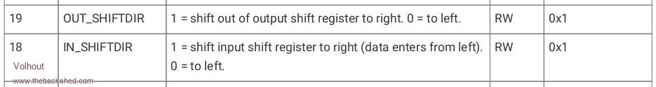

Posts: 6104
Posted: 07:22pm 02 Jan 2023
Hi Peter,
Yes, there is one other thing I would like to add. It relates to the helper function for SHIFTCTRL.
PIO (SHIFTCTRL
push_threshold
[,pull_threshold] [,autopush]
[,autopull])
Could you please add the booleans that control the shift direction. These are bit 18 and 19 of the register.
This will be part of the training if you add it.
There are many area's I did not even touch yet, so this may be not complete (I have not even touched IRQ's myself).
In the EXECCTRL there is a bit SIDE_PINDIR that sounds useful. You can use it to create a serial open drain bus. There is much more, but adding too much will likely confuse more than it adds. When in doubt I can always directly write to the register.
Edited 2023-01-03 05:23 by Volhout
Posts: 11850
Posted: 07:52pm 02 Jan 2023
I think they are there but perhaps the manual needs updating
