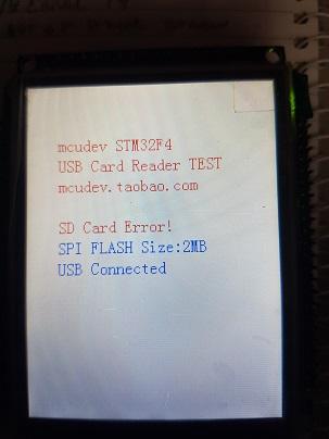

I purchased some STM32F4 black boards and I have found one of the boards will not program via the ST software. I cannot get the unit to register in the cube software like the other units but if I take off the BT0 and BT1 links the screen displays this:
Can anyone offer any ideas?

Are you reconnecting the power with BT0 and BT1 strapped, I have found just resetting via the RST key can be a bit hit and miss, but a full power off/on always works.

Only other thing I can think of is checking continuity from the BT0 pin to pin 94 on the actual chip itself. Also BT1 to pin 37 on the actual chip.

Does the chip have the right markings for the CPU it's supposed to be?

I have traced the BT0 and BT1 pins back to the chip via R23 and R33 so no luck there.
@JohnS
I can confirm that the chip is the same as the others
@Jim
I grabbed another board of the same build (DevEBox V33) and checked the pin configuration and it is recognized by the Cubeprogrammer.
I did reflow the ARM chip and changed the crystal and battery but still the software will not recognize the board. It is strange that there is life when the screen above shows.

It does appear to have a program installed.
If you can't erase it and load your own, perhaps whoever loaded the original program made it write protected in which case I don't know where to go next.

I hit something which might be along the same lines and ended up using both Texane stlink & qstlink / qstlink2 (one or other fixed whatever it was).
I think the issue was probably corrupted option byte(s).

Jim, the unit is fresh out of the bag from the supplier. The units that have programmed with MMBasic are still recognised with Cube software.

I think it was before OpenOCD had SWD support, or it just couldn't recover from whatever weirdness had occurred, about 9 years ago. You might well just be able to use oocd now.
Looks like Texane stlink is now https://github.com/stlink-org/stlink
I think the other was https://github.com/fpoussin/QStlink2
