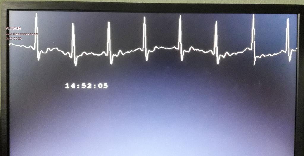

Hello,
I am trying to understand the framebuffer and simply don't get it. All I want to do is this example Peter showed on YouTube (https://www.youtube.com/watch?v=dLk7JgB3YCY), where he has a background image and a moving sine wave on the top layer.
The manual is good, but does not help how to begin with.
I think first of all I have to load my desired image
load image "grid"
Then create a framebuffer with
framebuffer create
now (in my mind) I've created a framebuffer with my background image "grid"
Then I want to put my moving sine function on top of that with
framebuffer layer
Because the manual says: "Allocates 38400 bytes of variable memory to a second display layer. This
layer sits on top of the main display." So exactly what I want. now I am drawing my moving sine wave on top, but nothing works the screen goes black.
This is always my problem with complex commands, I read the manual, but I don't know how to start at all. Is there anywhere Peters YouTube example of it? I've looked at Martins framebuffer examples with sprites but they are all too complex to begin with.
My final application is my ECG, which works good but needs some grid in the background and I thought it would be much better with framebuffer than drawing horzontal and vertical lines.
This is my ECG, which works good so far, but a background grid would be much nicer.

Posts: 11848
Posted: 05:19pm 25 Mar 2023
MODE 2
FRAMEBUFFER create
FRAMEBUFFER layer
For x=1 To MM.HRes-1 Step 16
Line x,0,x,MM.VRes-1
Next
For y=1 To MM.VRes-1 Step 16
Line 0,y,MM.HRes-1,y
Next
i=0
FRAMEBUFFER write f
CLS
For j=i To MM.HRes-1+i
l=k
k=Sin(j/MM.HRes*2*Pi)
If j<>i Then Line j-i-1,l*100+MM.VRes/2,j-i,k*100+MM.VRes/2,,RGB(red)
Next
Inc i
FRAMEBUFFER copy f,l,b

Hi Daniel,
Framebuffer N is the actual screen
Framebuffer F is the Buffer which is never visible but you can hiddenly draw on it and copy it to Framebuffer N or L
Framebuffer L is a Layer, Everything that is written or drawn here is placed over the Screen like a foil without changing the content of screen(n)
(Like a 100% opaque Layer in Photoshop).An exception here are black pixels, these are transparent in the layer, so the content of the screen(n) "shines through" all black pixels on Framebuffer L
I hope that was somewhat understandable
for example look at my "on the road again" demo, here the screen is drawn hidden  on Framebuffer F and copied to N when ready,
the Car is shown on Framebuffer L so that it doesn't affect the background
Mart!n
