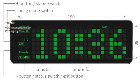

G'day All,
Purchased this (see below) from Waveshare to tinker with, turns out you need to multiplex the led displays from the Picomite so its been a fun exercise to get it to work smoothly with both the multiplexing and dimming together.
As part of this, I looked at using both the framebuffer (option LCDPANEL virtual_m) and user (option LCDPANEL user) options, the framebuffer method is currently working by finding it in memory and reading it into an array every second to update the display. This is a work in motion but the code below is a start.
Does anyone know if the pointer to the framebuffer is visible to MMbasic?
The LCDPANEL USER option has been a non-starter, I think I am trying to use it incorrectly and there is very little mention of it on the forum, are mmbasic lcd drivers implemented on the PicoMite?
So far have tried every combination of OPTION LCDPANEL USER, X, Y / OPTION LCDPANEL USER X, Y I can think of with no joy, this is on a fresh install of 5.07.07 with no other option set. It exists in the source code but my understanding of C is limited, hence the love of MMBasic.
I have a couple of other displays with odd driver chips to tinker with so any help with this would be appreciated.

Posts: 11251
Posted: 11:22am 12 May 2023
mm.info(writebuf) will return the address of the buffer currently being used for graphics output
so
FRAMEBUFFER CREATE
FRAMEBUFFER WRITE F
add% = MM.INFO(WRITEBUFF)
should do what you want
