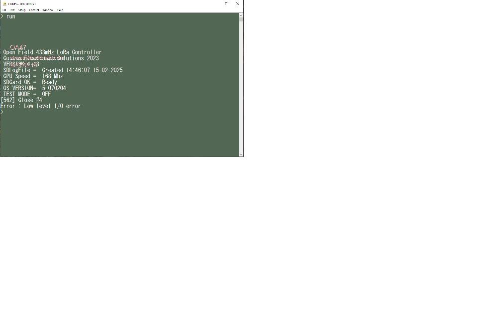

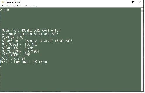

disco4now I have been testing the latest beta on the test bench but I am still not out of the woods. Here is a screenshot of the error that is occurring:
Here is the offending code that I have unsuccessfully modified to try and get round the issue.
Sub DbPrnt
DbClock$=Left$(Date$,2)+Mid$(Date$,4,2)+Mid$(Date$,9,2)+" "
DbClock$=DbClock$+Left$(Time$,2)+Mid$(Time$,4,2)+Mid$(Time$,7,2)
NewScrnMsg$ = DbClock$ + " " + DbMsg$
If Len(DbMsg$)>0 Then
 Print #2, NewScrnMsg$
 If NewScrnMsg$ <> OldScrnMsg$ Then
 ScrnMsg$ = NewScrnMsg$
 For Y=12 To 1 Step -1
   DisplayLog$(Y)=DisplayLog$(Y-1)
 Next Y
DisplayLog$(Y)=ScrnMsg$
 For X = 1 To 12
   CtrlVal(70+X)=DisplayLog$(X)
 Next X
' SEND PORT SCANS TO SCREEN AND NOT SD FILE
  If Left$(DbMsg$,1)<>"." AND Left$(DbMsg$,1)<>"0" Then
     If MM.Info(SDCARD)="Ready" Then
       Pin(PA6)=0
       On Error Skip
       Close #4
       Open CFN$ For Append As #4
       Print #4, ScrnMsg$
       Close #4 <<<<<<<<<<< LINE 563
       Pin(PA6)=1
     Else
       GUI DELETE SVE
       GUI BUTTON SVE, "SD ERROR",230, 20,80,20,RGB(RED), RGB(yellow)
     EndIf
  EndIf
EndIf
EndIf
OldScrnMsg$ = ScrnMsg$
End Sub
Unfortunately this latest event resulted in the program failing to a prompt but the mmbasic code was still in memory. I do have this sub.
SUB MM.STARTUP
OPTION AUTORUN ON
END SUB
OA47

I have just thought of introducing a delay between the SD card operations, that may help things.
OA47
disco4now
Joined: 18/12/2014
Posts: 1151
Posted: 06:04am 16 Feb 2025
I think you need the ON ERROR SKIP before the line
The test for the MM.info(SDCARD) tries to access the SDCARD so this would be where it fails.
Also
ON ERROR SKIP only skips an error on the next line.
i.e.
ON ERROR SKIP nn
ON ERROR SKIP will ignore an error in a number of commands (specified by
the number 'nn') executed following this command. 'nn' is optional, the default
if not specified is one. After the number of commands has completed (with an
error or not) the behaviour of MMBasic will revert to ON ERROR ABORT.
You may need to specify the number of lines you want to skip errors on.
Maybe something like this.
    SDCARDStatus="Failed at MM.INFO"
    ON ERROR SKIP 1
    SDCARDStatus=MM.Info(SDCARD)
    If SDCARDStatus="Ready" Then
      Pin(PA6)=0
      ON ERROR SKIP 4
      Close #4
      Print #4, ScrnMsg$
      Pin(PA6)=1
    Else
      GUI DELETE SVE
    EndIf
 EndIf
F4 H7FotSF4xGT
OA47
Joined: 11/04/2012
Posts: 1051
Posted: 06:25am 16 Feb 2025
Ok disco4now, I will implement your suggestions. Any thoughts on the "ERROR : Low level I/O error" dropping to a prompt ?
OA47
disco4now
Joined: 18/12/2014
Posts: 1151
Posted: 08:33am 16 Feb 2025
Its an error from the SDCARD for some reason. I think its dropping to the prompt because the current ON ERROR SKIP is not being applied when it occurs as it applies only to the first CLOSE #4. I think the error is on the subsequent one, so the ON ERROR SKIP 4 should cover that.
A further look at the code seems to indicate that the MM.INFO(SDCARD) should not cause an error, it would just return 'Not Present' instead, so the ON ERROR SKIP around the MM.INFO is not required.

Posted: 08:56pm 16 Feb 2025
OA47,
Are you using any interrupts in the code?. e.g TIMER, SETPIN xx,INT on any pins or interrupts from the COM ports. Do any of these call Sub DbPrnt?
Just checking because calling any SUB from both the main code and also from an interrupt is a big don't do it.
Gerry

Posted: 10:21pm 16 Feb 2025
Gerry, the only interaction with the Sub DbPrnt and any interrupts is when it scans the 16 ports:
Dim ScanPortTime = 500
SetTick ScanPortTime,ScanPorts
Sub ScanPorts                       'Interupt timed with ScanPortTime
SetTick 0,ScanPorts                'Turn off Interupt
Com2Chk                            'Check for message from PC to remote
Pulse PA7,2.5                      'Pulse LED on F4 to indicate operation
RCMsg$=Input$(80,#1)               'Look for any Messages from REMOTES
LkForMsg                           'Look for message from any remote LoRa unit
If Right$(Time$,1)="0" Then        '10 second interval
  CntlrScn                         'Scan controller outputs for any change
  VChange                          'Identify output change from controller
EndIf
Status$=Valve$
If Right$(Time$,2)="19" Then       '60 second interval
  CTime=CTime+1
  DbMsg$= "CTime="+Str$(CTime)+" Valves="+Str$(ValveCount):DbPrnt
  If ValveCount > 0 Then           'At least one valve is in operation
    If Ctime>3 Then PresChk        'Check Pressures of all enabled valves
  Else
    If Ctime>20 Then PresChk       'Check Pressures of all enabled valves
  EndIf
EndIf
If Right$(Time$,5)="00:50" Then SDI_Chk    '60 minute interval
' If Right$(Time$,2)="50" Then SDI_Chk    'TEST 1 minute interval
Valve$=""
End Sub
Not sure if there is a "don't do it" in there

disco4now
Joined: 18/12/2014
Posts: 1151
Posted: 11:20pm 16 Feb 2025
This looks like a 'don't do it' especially if DbPrnt is called anywhere in the main DO:LOOP
The code above is all executing  inside the interrupt. So think in terms that its possible that all the above code could insert itself at any time and at any point within the main DO:LOOP. This becomes a bit hard to think about.
Its easily fixed by following the guideline, keep interrupts short,set a flag and do the work in the main DO:LOOP
Something like this.
'Main Loop
DO
 if ScanPortFlag=1 then
  ActionScanPorts
  ScanPortFlag=0
 end if
LOOP
'Keep It Short, Set a flag
 ScanPortFlag=1                    ' Set Flag
End Sub
Sub ActionScanPorts                'Interupt timed with ScanPortTime
'''''SetTick 0,ScanPorts                'Turn off Interupt
EndIf
Status$=Valve$
 CTime=CTime+1
 Else
 EndIf
EndIf
Valve$=""
''''''SetTick ScanPortTime,ScanPorts
End Sub
