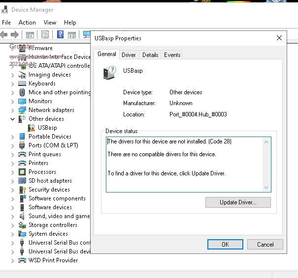

I have just plugged in a USBasb programmer, but Windoze wants drivers for it.
I hoped it would just I.D. as a standard COM port, but aparently not.
Can anyone help me find the drivers I need to make this thing talk?
Thanks muchly.

Posted: 06:40am 31 Aug 2023
Gogster.
I found drivers for Linux and Windows
Please look these. maybe it will help
https://www.fischl.de/usbasp/

Posted: 07:08am 31 Aug 2023
https://www.instructables.com/USBASP-Installation-in-Windows-10/

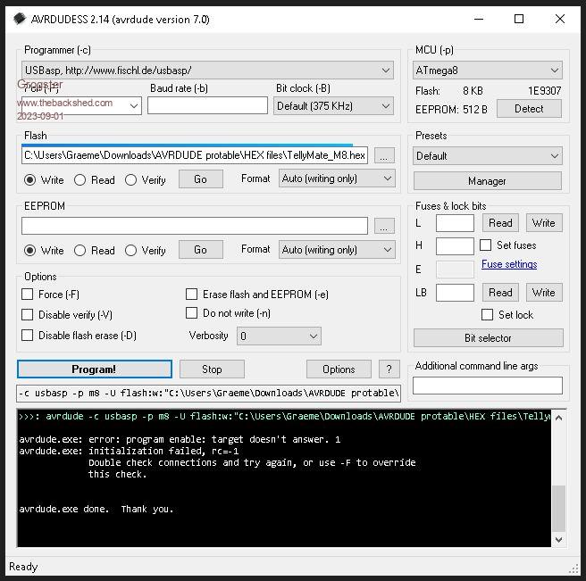

OK, I have installed the driver, and Windoze seems to be able to see it there:
But AVRDUDE does not want to talk to the chip - in this case, a 28-pin MEGA8.
I am totally unfamiliar with Atmel MCU's - do I need to install a 16MHz crystal oscillator on the breadboard?  With PIC's, you don't need to install a resonator or crystal to program them most of the time, but Atmel controllers might be different.
In the case of this MEGA8, I have connected both Vcc(7) and Avcc(20) to the 5v Vcc from the USBasp programmer, both GND pins(8 & 22) to GND, and set the voltage selector jumper to 5v.
I have SCK from the programmer on SCK(19) on the MEGA8.
I have MISO from the programmer on MISO(18) on the MEGA8.
I have MOSI from the programmer on MOSI(17) on the MEGA8.
There is 5v on the power pins of the MEGA8.
This MEGA8 is supposed to be running the TellyMate composite video output program, and it's OSC is a 16MHz crystal.  I think I might need that, so I will install that on the breadboard and try again, but if someone can just confirm for me that Atmel MCU's must have that crystal OSC in place to even program at all, that would be helpful.

Tony M
Posts: 10037
Posted: 06:07am 01 Sep 2023
Thanks, that helped!
I dropped the bit clock to 187.5kHz, but still no talkie.
I will fit the crystal now, and see if that does it.
I'm just not quite sure what the hell I am doing when it comes to Atmel MCU programming!
EDIT: Added a 16MHz crystal across pins 9 & 10, with 22pF caps to GND, but the MCU is still undetected.
I must be doing something fundamentally wrong, but I can't currently see what that is.
Thought it would spring to life once I added the crystal and caps....
Edited 2023-09-01 16:23 by Grogster

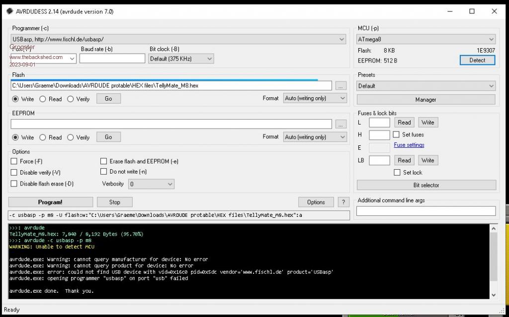

Posts: 10037
Posted: 07:17am 01 Sep 2023
Not a sausage.
Here is the output, when I click on DETECT:
Posts: 6603
Posted: 07:22am 01 Sep 2023
third line
could not find USBasp.
You need that bit fixed before you worry about the MEGA8
Posts: 10037
Posted: 07:32am 01 Sep 2023
But....I installed the drivers, and Windoze is happy that it can see it.
I have selected it in AVRDUDE - what gives?
Is there any way to troubleshoot THAT aspect of things?
Posts: 6603
Posted: 07:42am 01 Sep 2023
Check the Hardware IDs and make sure they are USB\VID_16C0&PID_05DC
Posts: 10037
Posted: 07:47am 01 Sep 2023
OK, thanks Jim, I will try that - tomorrow.
For tonight, I have had enough of fighting this damn thing, so am going to go to bed and watch a movie or three.
Thanks to everyone who has replied so far, and we'll take this up again tomorrow.

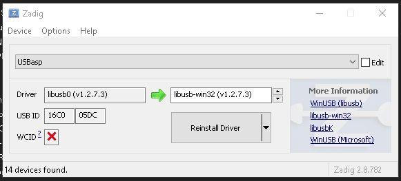

Posts: 4378
Posted: 08:35am 01 Sep 2023
It does look like it can't see the USB device (usbasp) at all.
On Windows, zadig often seems the answer to USB driver issues.

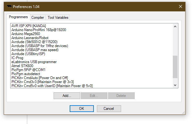

Posts: 2807
Posted: 03:00pm 01 Sep 2023
Doubt if relevant but Great Cow Basic programmer supports USBAS

Posts: 11842
Posted: 03:12pm 01 Sep 2023
On windows use must use ZADIG and must choose the correct driver - you want libusb-win32. This is not the default - use the dropdown. Suggest you uninstall zadig and start again
Posts: 10037
Posted: 12:01am 02 Sep 2023
@ JIM - VID & PID match.
@ matherp - I did follow the ZADIG program, and did select the win32 driver INITALLY, but when I rerun ZADIG, it says it is trying to use libusb0 driver, so I have selected libusb-win32, and will try again.
This is how I am about to proceed:
Wish me luck!
EDIT: Nope.  "Unable to detect MCU".....
However, NOW I am not getting the USBasb error line in AVRDUDE, and besides that I am also now getting a 2nd red blinking LED on the programmer module, when I try to do things, so I think AVRDUDE is happy enough that it can see the programmer now, so I will still take that as progress!!!

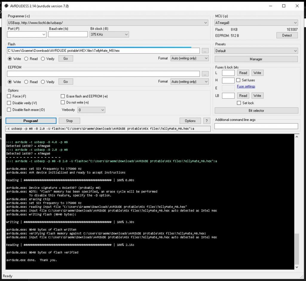

Posts: 10037
Posted: 12:22am 02 Sep 2023
Owwwww - "Detected 1e9307 = Atmega8"....
Lets see if I can program it....
YAY!!!
...and I have discovered that you DO have to have the 16MHz osc in place for the chip to even be detectable at all.  Just tried to do a 2nd mega8 chip without the osc, and no talkie.  Put the crystal and two caps back again, and talkie talkie talkie!
But progress!
I will now program the remaining four chips and store them labelled as programmed with the TellyMate firmware.
Edited 2023-09-02 10:28 by Grogster
