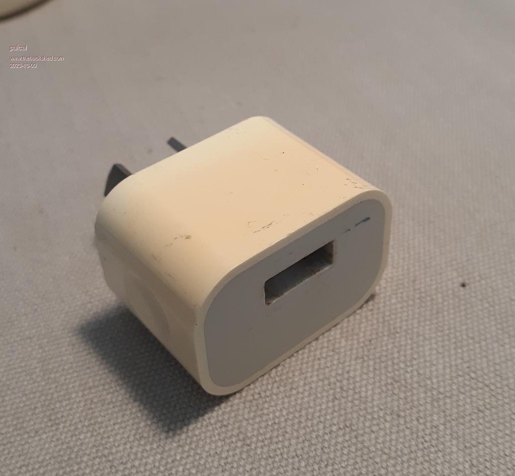

Hi all,
To save me breaking it open, does anyone know what electronics are inside.
Are they safe to use with a Micromite or Picomite ?

Your guess is as good as mine. If it's a decent make then it's probably ok. If it's a super-cheap Chinese thing then I'd be very wary.
The circuit is a switching converter. The possible danger arises in the distance between the tracks on the PCB and in the quality of the HF isolating transformer used. Some are fine, others are next to lethal.
Try plugging it in and measuring the voltage between the USB shell and mains earth. Try it with and without a shell=earth load of about 1K. If you get any voltage in the latter case then there's almost certainly too much leakage to consider it safe. You can get away with a tiny bit of leakage for a charger but not if you are going to keep putting your fingers on it. You could try linking negative output to mains earth but that might stress the transformer.

USB shell to ground measures 100 volts, with the 1K resistor I get zero.

Almost all 2 pin mains devices have some deliberate leakage between mains and output as a safety measure.
It is usually via a high value resistor though some use a low value capacitor as well.
The intention is to blead away any electrostatic charge accumulating on the output (which can be many thousands of volts) that could cause the transformer insulation to break down.
If correctly designed they must accept one output terminal being tied to earth.

I wouldn't get too upset if there's no voltage with a 1K resistor. You might like to connect the negative output to mains earth just to be safe. The 100V that you see has virtually no current capability.
It's not easy to say whether these things are "safe" without ripping them to bits. They don't work at all then. :)

A lot of no-name mains equipment doesn't have very good clearances.
I would rather see a brand-name charger, especially for someone else.

Seeing the picture, it is a 2 pin mains connection. This means it does not rely on safety ground pin in the socket. This makes it a class II device. For 250Vac class the isolation should (between mains and 5V side) be tested at 4240V (4.2kV) according to CE regulations. Whether this device meets that test voltage, I cannot tell.

I think that regardless of Class I or Class II isolation, the test would still be to mains earth on the LV side. The difference is that in Class II there should be an additional insulating barrier in case the primary one should fail.
The Class II charger shown *should* have basic (wire insulation) and reinforced (additional insulation layer) insulation on the transformer with an opto-isolator or additional insulated winding for feedback. Additionally the PCB should be able to withstand the isolation voltage. UL regulations state this as twice the working voltage + 1000 volts for 1 second. The UK says that the resistance should be greater than 1M when measured using 500V AC between mains input and LV output.
