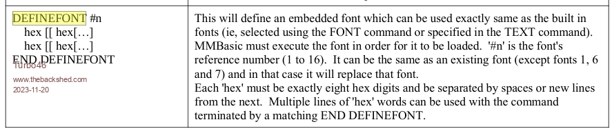

Posted: 01:52am 20 Nov 2023
Or Definefont:
Bill

Posted: 02:09am 20 Nov 2023
just merge them to your Source code
Fonts for Mites
'no comment
