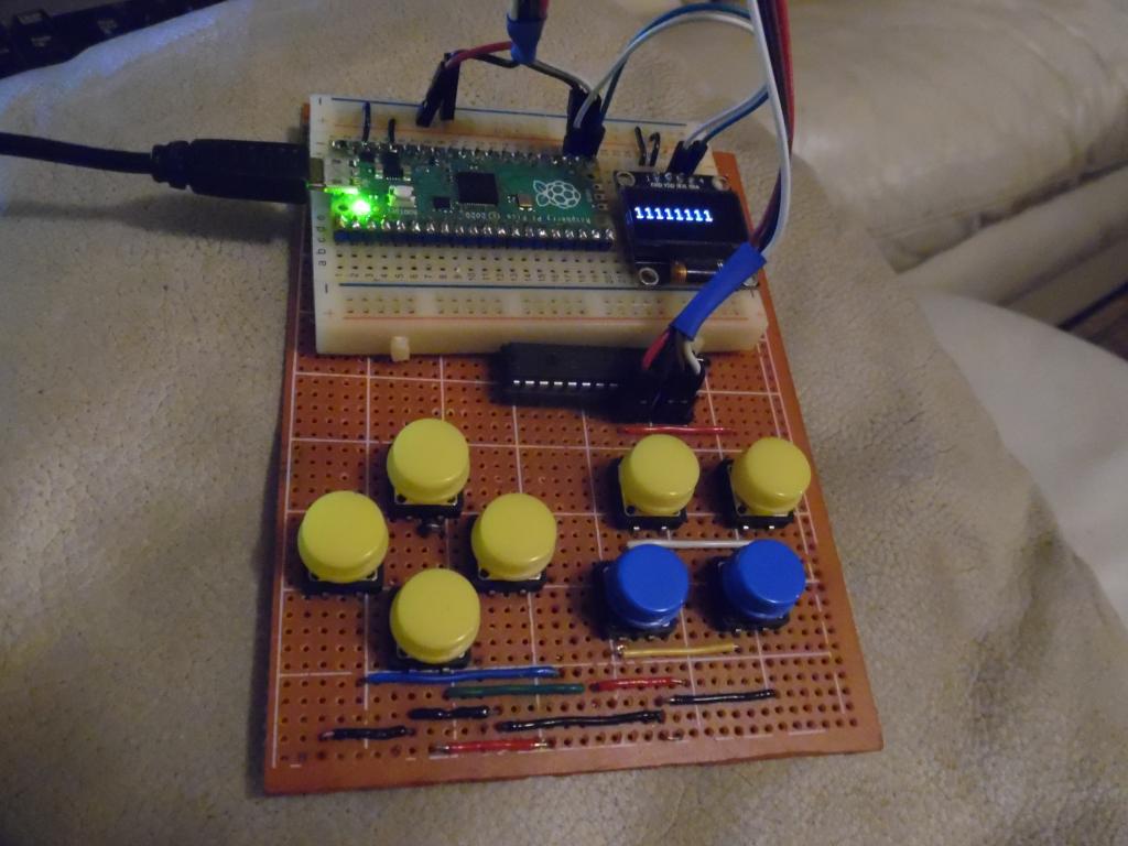

I got mcp23017 port expander and ssd1306 on same i2c to show buttons pressed as binary and works fine...button pad is not as simple to make as seems :)
When wired to ili9341 it displays 00000000, so display is working ... but on ssd1306 it's 11111111 for no buttons pressed. works well, pressing 8 buttons gives 00000000.
for it to flash needed
'SETPIN gp20, gp21, I2C
'I2C OPEN 100,100
it don't work with ili9341??

Posts: 2807
Posted: 11:36pm 17 Dec 2023
this is the ili board so 'SETPIN gp20, gp21, I2C not used?? ok for i2c?

OPTION SYSTEM I2C GP20,GP21 gives
Error : Pin 26/GP20 is in use

Posts: 3378
Posted: 12:27am 18 Dec 2023
What happens if you change to:-
OPTION SYSTEM I2C GP2,GP3 'second I2C
Something seems to be tying up either GP20 or the first I2C.
As Lizby said what sort of display you use shouldn't matter, in any case printing to the console always shows what is really going on.

Posts: 2807
Posted: 03:52pm 18 Dec 2023
  Volhout said  Are the keys connected to port a. Or to port b.?
You are reading GPIOB into the value portAbits.
Confusing.?
I'm reading portB, should have changed the var name to portBbits.
It works with it wired to same i2c as the ssd1306, it's the i2c and spi ili9341 which is a different board and pico.
I will try another i2c device that works with ssdi306 but use ili9341.
Posts: 2807
Posted: 05:00pm 18 Dec 2023
I used OPTION SYSTEM I2C gp0,gp1 and it works with ili9341 board ok now??
Is option reset the only way now to change the system i2c now to other pins?

Posts: 3378
Posted: 08:57pm 18 Dec 2023
  Quote  Is option reset the only way now to change the system i2c now to other pins?
To change a single Option first Disable it then apply the new settings.
eg:
OPTION SYSTEM I2C Disable
OPTION SYSTEM I2C GP0,GP1
Posts: 2807
Posted: 09:49pm 18 Dec 2023
eg:
Thanks phil, better than set it all up again I'm dim. wanted wires same side as 3.3v out. Thanks to all for the code to get mcp23017 expander working.
