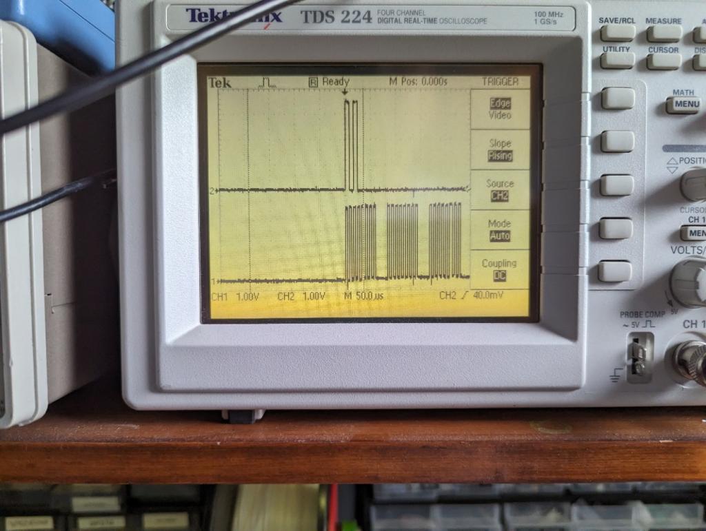

Hi Peter,
Hate to disturb you, but there is another bug in PicoMiteVGA (not in the standard PicoMite) with SPI. See below program. The SPI is set up for 8 bit transfers.
The first set of xxx=SPI(yyy) work (easiest is to see that there are 3x8 clocks on a scope).
Then there is a loop where 4 ADC channels (24 bit) are read, then finally a section where 24 bit (CRC data) is read.
If I run this code in PicoMite (normal pico) it works fine.
It uses GP2,3,4,5) that are also free to use on the PicoMiteVGA (your reference board 1.7).
But when I run it on the PicoMiteVGA, it sends the first 3 xxx=SPI(yyy) commands, and then stops.
When I comment out the PRINT commands, all SPI commands are send.
So some way, the PRINT is blocking furter SPI commands. Since PRINT statements to VGA consume time, I checked is there other clocks where simply delayed, but that is not the case.
I have no idea what happens. This is on 5.08.00.

Posts: 11830
Posted: 10:00am 27 Feb 2024
Can't replicate - working perfectly for me

EDIT:
post removed, needs mor investigation form my side.
I was looking at a problem with the ADC. When the VGA picomite prints data, and needs to scroll the screen, that consumes 15ms in time. The ADC looses sync (have to investigate why) when there is more than 3ms between reads of ADC channels. Pobably becuase it has new ADC data, and the SPI is busy, so it can't store the data anywhere.
The ADC is in "free run" mode.
I now read the channels immediate, and print later. That works.
Engineering is fun !!!
Edited 2024-02-27 22:30 by Volhout
Posts: 11830
Posted: 12:08pm 27 Feb 2024
I'm not making it up
V5.09.00b3 as copied from your post will all print statements
