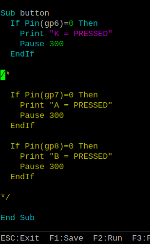

hi all;

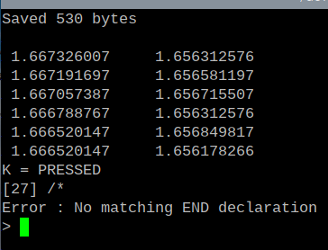

I'm using the newest release of picomite code and perhaps my error is not understanding the wording in the manual regarding multi line comments.
I am getting an error that I think is telling me the end of the comment is missing.
Here are the screen shots;
I just wanted to comment out a bunch of code, without the comments the code all works.
Thanks for your help guys.
Hans ...

I don't know if Basic has multiline comments, and it's strange to use C style comment blocks. I could be wrong, but is strange
Posts: 9122
Posted: 06:38pm 29 Jan 2024
MMBasic does have multi-line comments now. :)
Does it work if you use individual comments on each line, Hans?
What happens if you run it as a DO/LOOP instead of calling it as a SUB?
EDIT:
I've just tried something similar and it looks to me as if */ isn't closing the comment.
On removing the multi-line comment marks the editor reverts to b/w too, although adding a new ' comment still colours that correctly. Other new commands aren't coloured.

Posted: 09:17pm 29 Jan 2024
Hi Mick;
Yes it will run without error if I individually comment each line.
I just thought it would be nicer to comment out a bunch of lines with this new functionality.
But now it's a case of understanding what the manual is saying in the event I have a larger project and want to mass comment.
The sub routine is actually an interrupt handler for the buttons pushed. I probably should have mentioned that.
Did not try the do loop and you can see why in the program I provided. I have an Arduino pinned hat with a joystick and 6 buttons. Too many wires in the way to test coding with just the joystick so I dug the joystick out of my Arduino kit and just wired it separately.

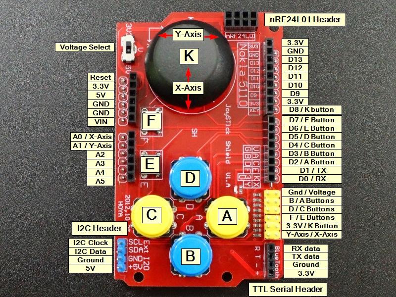

BTW this is the original controller I was using. I got rid of the headers on top of the board.

Posts: 9122
Posted: 10:07pm 29 Jan 2024
No, I think what you've done is correct.
this is
a multiline
comment
*/ and you can use this line as well
works correctly as a piece of stand-alone code.
Posts: 11832
Posted: 10:48pm 29 Jan 2024
Multi-line comments can't be used inside subroutines and functions - this is a limitation of the way they work
