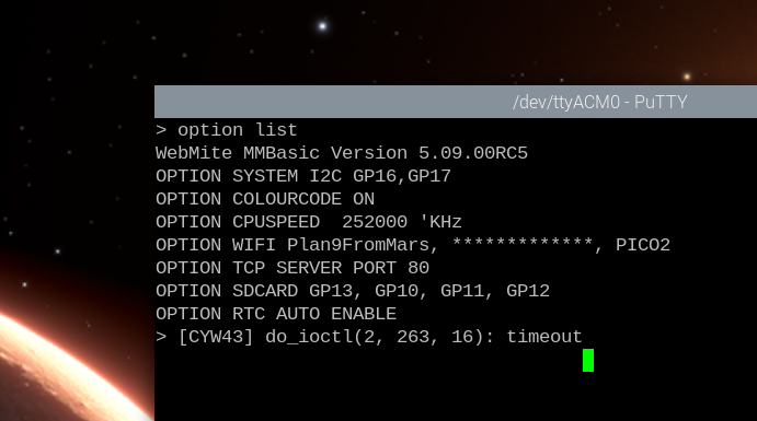

Hi All;
Don't know what this is but after opening my WebMite on RC5 and just leaving it for about 3hrs, up came this error message. It was not running a program.
After seeing it I hit ENTER and continued on doing stuff as if nothing happened.
Don't know what it means but there it is.
Hans...
PS: This error was posted previously by Malibu in April 2024.
