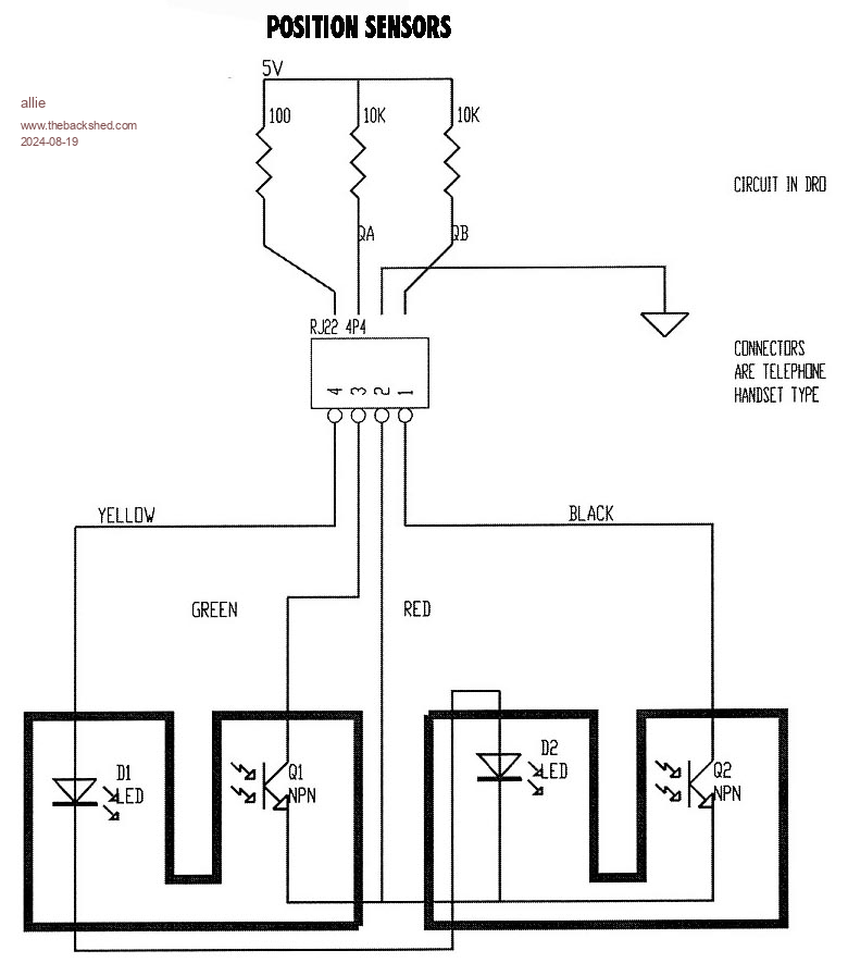

Please post the encoder details. Pretty sure we need to level shift from 5v and there's a possibility that we have differential signals. All easy to accommodate
Yes I'll have to level shift. I have one that shifts from 5v to 3.3 as long as it can handle the speed.

Level shifting:
As we only need uni-direction, I use the 74HC4050 device.
Posts: 3376
Posted: 08:28am 19 Aug 2024
The "Position Sensors" circuit above will work if powered from 3.3V, then you don't need a level shifter.
If the LED current is too low at 3.3V reduce the 100Ω resistor to 68Ω or 51Ω.
Plan "B" would be to continue to have the 100Ω connected to 5V but have the 2 x 10kΩ connected to 3.3V.

  phil99 said  The "Position Sensors" circuit above will work if powered from 3.3V, then you don't need a level shifter.
Thanks for the info I'll use plan "B".
