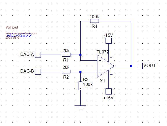

2/ Using a DAC (MCP4822)
The DAC has a different interface. It is controlled from a serial datastream. The MCP4822 DAC is controlled from SPI. Picomite has a hardware SPI controller that can send out (up to) 16 bits of data in a single MMBasic command. But the DAC does not need a low pass filter (or a very simple one). So there may be more delay in shifting the bits out, but less delay in the filter (if any).

Yeah, I have experience with different levels of PWM filtering and TBH, it doesn't seem to make much difference in motor control. I always end-up with a rock-steady motor shaft.
The servo-drive's analogue inputs have filtering and the command signal always looks noisy anyway, due to the PID maintaining the commanded position.
Best is to use the DUAL DAC (both channels) to generate a single +/-10V output.
Really? Don't believe I ever came across this but it sounds cool
Do you have a schematic?
Posts: 6101
Posted: 08:44am 01 May 2024
Something like this:
This circuit should translate 2V output of the DAC to +/- 10V.
It outputs the difference between A and B. So write 4095 to A and 0 to B and you have -10V. St both to 0, or 4096, or 1999, and the output is 0. A=0 and B=4095 is +10V.
Easiest is A = 4095-B
Resistors must be 1% or better.
Edited 2024-05-01 18:45 by Volhout
PhenixRising
Joined: 07/11/2023
Posts: 2076
Posted: 09:42am 01 May 2024
So instead of 20V/4096, I now get 20V/8192 (13bit effectively)?
Posts: 6101
Posted: 09:51am 01 May 2024
EDIT:
Yes essentially you could get 13 bits.
But not with A=4095-B
Edited 2024-05-01 19:58 by Volhout
