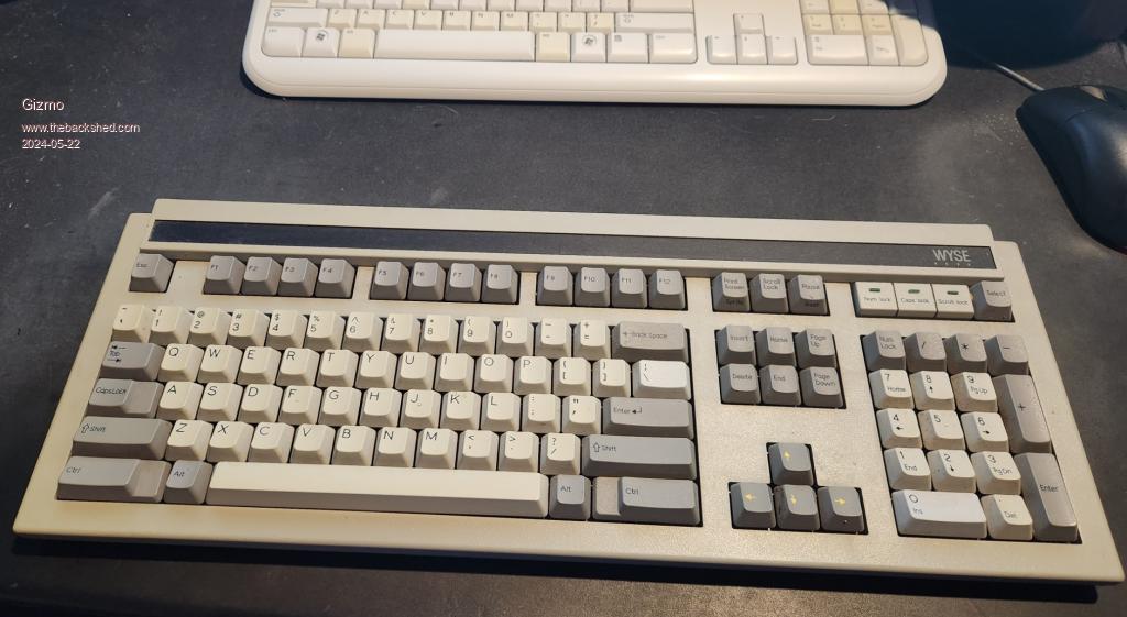

Hiya
Been looking for the perfect keyboard. Tried the keyboards with the tap tap laptop type keys, noop. Currently using a keyboard with more of a clunk clunk type keys, its OK, but wonder if I can do better.
Looking though some old keyboards, I found my old AT Model F keyboard from the 80's. This thing's as heavy as a house brick. And ooooh those keys, feel perfect. But its a old layout and wont suit my typing style.
The I found a pair of old WYSE terminal keyboards. The keys feel great. Not as good as the AT but better than anything else I've used in the last 20 years.
These use a special interface over 4 wires. Its well documented, and I did find a project online which involved using a Teensy 2.0 board as a adapter. Problem is, the Teensy boards are expensive, when they are in stock.
Just wondering, does the PicoMite have the ability to emulate a keyboard? I can decode the WYSE signal and use a character map, but I would need the PC to recognise the PicoMite as a keyboard.
The other option would be using a ESP8266 ( I've got a few spares ).

Posts: 5193
Posted: 02:18am 23 May 2024
After some research I believe the software used ( Soarer's WYSE Converter firmware ) to convert WYSE keyboard to USB will run on a Arduino Pro Micro ATmega32U4, so ordered one, should be here in a week.
Its possible a Pi-Pico can be used in a similar way, to act as a Keyboard or Mouse when plugged into a PC. But unless I'm wrong ( usually am ) then this cant be accessed in Pico-Mite.
Maybe a function to consider, it would mean a PicoMite could be used to build your own keyboard or pointing device.

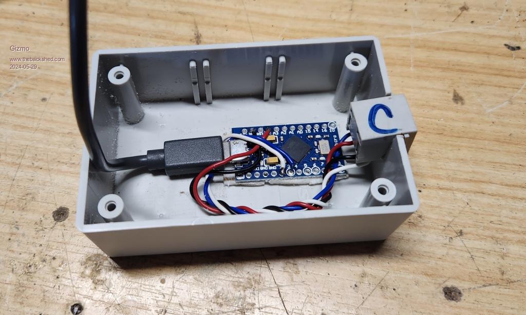

Posts: 5193
Posted: 07:22am 29 May 2024
OK, after a week of frustration, I got it working.
I ordered a Arduino Pro Micro, and went about installing Soarer's WYSE Converter firmware. Boy o boy, why they recommend Arduino for beginners is beyond me.
I had to install the firmware onto the Pro Micro, there's a bunch of "how to"s but none of them were working, the programmer just wouldn't flash the firmware. First you put the Pro Micro into bootloader mode by shorting the reset pin to ground, then you have about 8 seconds to start the upload. The instructions all say to first workout out what port the Pro Micro uses, then use a command line command to send the firmware to that port.
WRONG!
Well, partly. Just a case of poor instructions. Seams for the duration of the boot loader process, the Pro Micro creates a new ( different ) com port. So you need to watch device manager to see what new com port is created after you put the Pro Micro into boot loader mode, then dropped 8 seconds later as it reverts back to its usual com port. I put this temporary com port into the command, and it worked!
The instruction on this page pointed me in the right direction...https://deskthority.net/viewtopic.php?t=19035
I mounted the Pro Micro into a little box. Some people mount it inside the WYSE keyboard, and I decided to go this way as I wanted to use the WYSE keyboards spiral cord.
And its working. Typed this post on the wyse keyboard.
