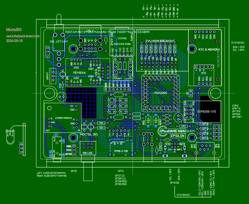

This is a board that's grown from the VGA versions in my "I got bored" thread. It's not at a stage where it could be built yet, but it gives you an idea. The case is the little Multicomp box that Peter has used, but if it has the MC prefix omitted from it's part number and says Hammond on it it's cheaper. :)
The little daughter board at the bottom left carries an LED that's used to illuminate a "secret until lit" logo on the front panel. There are different daughter boards depending on the LED.

Posts: 8966
Posted: 08:14pm 18 Aug 2024
No, no audio on DVI. Never heard of those chips either. :)  I don't know if the RP2350 could do anything with it. Isn't the audio encoded into the hdmi signal? The HSTX handles all that side, I think.
I'm unsure about it anyway. The speakers in TVs and monitors are usually pretty grim, certainly not up to the standard of even mediocre headphones. I've included a pretty good headphone amp and a manual volume control, complete with isolating caps to keep DC off the inputs. That output could be used to drive an amp, amplified speakers or even sensitive passive speakers.

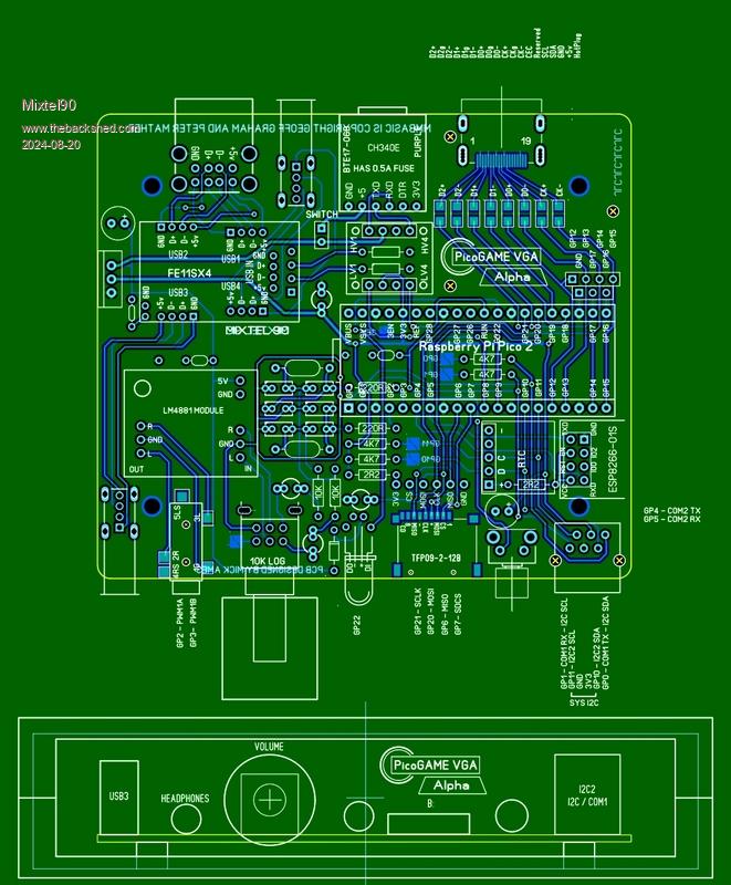

Posted: 06:16pm 19 Aug 2024
I've just ordered some test PCBs for the Pico 2, using SMD HDMI connectors. These are 100mm x 100mm and fit the little case, as described earlier. Obviously these are completely untested and at the moment the BOM and schematic are only in my head so it's not a beginners project. Bits are generally from AE.
Alpha gerbers.zip
The ADC pins aren't used but I've not brought them out to anywhere.
The LED is a 5mm version of the WS2812B.
The connectors above the top right end of the Pico are for fitting a VGA board that replaces the HDMI if I can't manage to solder it! I have the VGA board design ready just in case.
There is a no-copper area at the top right. It's a test area. I'm using 1.2mm white PCB and testing for light transmission.
There is a HDMI socket soldering test area on the back of the board near the USB sockets.
The pot is an Alpha type, bought from Rapid Electronics. Similar ones without the metal bracket can be found on AE.
The socket at the bottom right is a RJ12 6P6C type that I got on ebay IIRC. There are a lot of manufacturers, but these have the notch at the bottom. The two unmarked resistors under the level shifter (which only has 4 pins on each side) are pull-down for the USB and may not be needed.

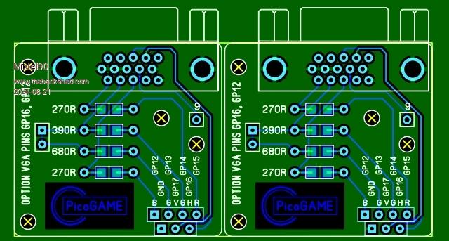

Posts: 8966
Posted: 02:17pm 20 Aug 2024
I've ordered the VGA adapter boards too. I've made these so that you can use one stand-alone as a VGA breakout board. Might be useful for someone.
VGAadap gerber.zip
If you use SMD resistors and saw the corner of the main board out this could be mounted flat down to replace the HDMI stuff. If it's mounted on pillars over the HDMI then you can split the two green signals to use HDMI or combine them to use VGA. :)

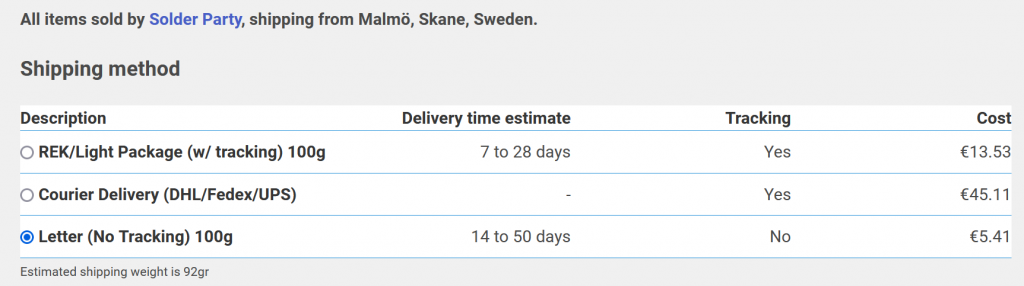

  Mixtel90 said  Yes. :)  When I last looked Solder Party didn't seem to have a UK distributor. What the postage will be from Sweden (one of the most expensive places on the planet) I don't know. It's not available yet, apparently)
I did a trial quote for 8 stamps with carrier board, 5 packs of flexi pins and 2 of the flexypins breakout/adaptor board just to get a decent weight for a quote, it's actually not that bad (IF you're not in a hurry)
No import duty as it's under £135
Hopefully they'll have the new XL versions in stock sometime soon.
