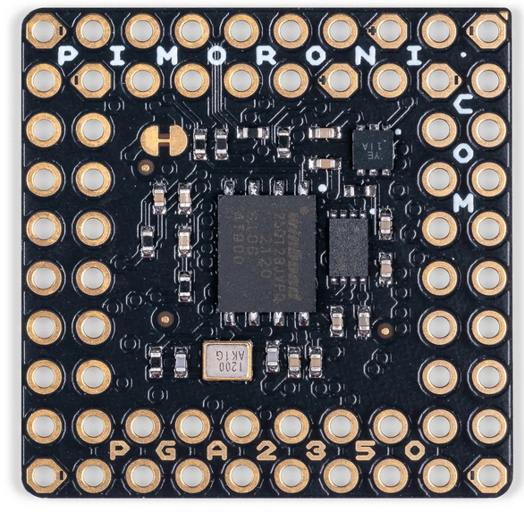

I assume this is on the bottom of the PGA2350? That's a view I've not seen.
Posts: 6548
Posted: 06:53am 27 Aug 2024
  Mixtel90 said  I assume this is on the bottom of the PGA2350? That's a view I've not seen.
both views for completeness.
Posts: 8966
Posted: 07:10am 27 Aug 2024
Thanks Jim :)
Much appreciated. :)

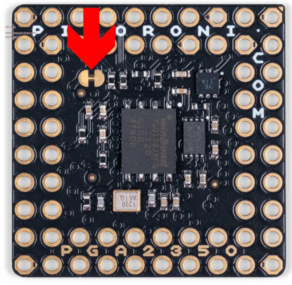

circuit
Joined: 10/01/2016
Posts: 307
Posted: 08:15am 27 Aug 2024
Thanks Jim, for posting the illustration.  (Excellent macro-photography, by the way.)
Just for clarity, the arrow marks the point of cut/connection and the solder pads for reversal.
Posts: 6548
Posted: 09:50am 27 Aug 2024
  Quote  Thanks Jim, for posting the illustration.  (Excellent macro-photography, by the way.)
Not my photos. Compliments of the Pimoroni website.
Posts: 4355
Posted: 03:07pm 27 Aug 2024
Good photos - thanks for finding them.
