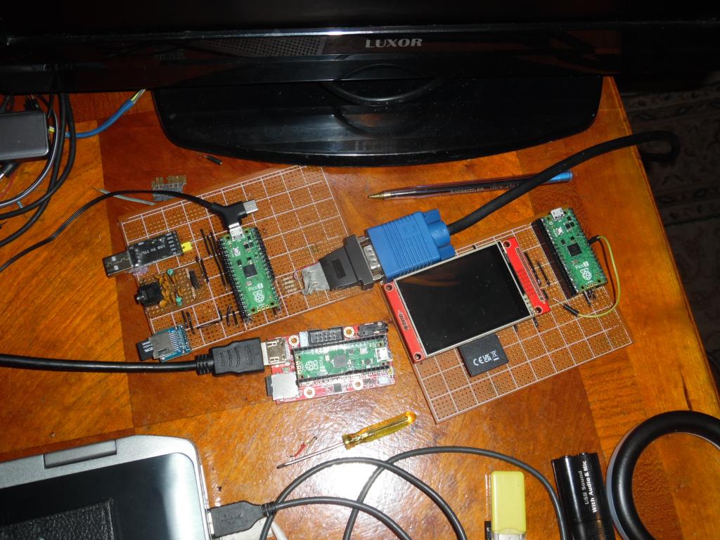

I Know if I did some searching I could find this out, but
1. Can I just Drop a Pico 2 in to one of my Pico Design 1 or Design 2  Boards ?
2. is the MMbasic for the pico 1 work ok on the  the Pico 2 ?
Thank you for PUTTING UP with my Lazy
Posts: 3820
Posted: 04:56pm 17 Sep 2024
  Rickard5 said  2. is the MMbasic for the pico 1 work ok on the  the Pico 2 ?
No. Must use the Pico2 firmware. But your programs should work.
  Rickard5 said  1. Can I just Drop a Pico 2 in to one of my Pico Design 1 or Design 2  Boards ?
Likely--for the most part. (I don't know enough to know the differences, though, and haven't yet received the Pico2 I ordered.)
Posts: 2807
Posted: 05:09pm 17 Sep 2024
yes, pico2 hardware uf2 for what version.
I got usb vga , picomite ili9341 and olimex hdmi working.
drop in replacement for 2040? some stuff works.
Posts: 2807
Posted: 05:23pm 17 Sep 2024
using picomite lcd then all you should see is a speed improvement. not the spi display but the program.
frame buffers seem different.
same with existing vga programs.
olimex hdmi is something else but seems to be worth using with the support so far
Posts: 8966
Posted: 06:00pm 17 Sep 2024
Designs 1 and 2 are conventional AFAIK. The Pico 2 should drop straight in.
You need to load it with the Pico 2 VGA version of MMBasic *without* USB support.
