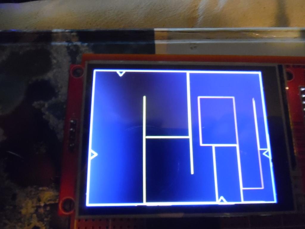

old tron game for ili9341. the gui touch areas are left right at the bottom of screen and up down right side of screen. 3 chasers tested pico 2

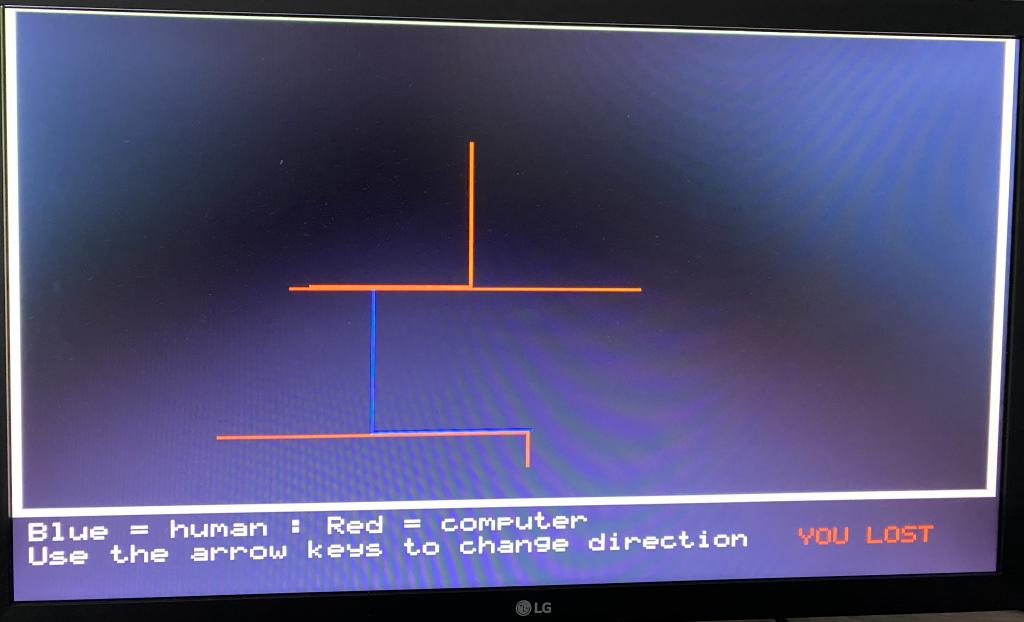

Hi all. I converted the Tron game for use on the PicoMiteVGA.
Added
- keyboard control
- instructions at the bottom
- made the game a bit easier (compdiff = computer difficulty).
'Tron ili9488
'By stanleyella
'PicoMiteVGA version by MarkF
'Keyboard control with arrow keys
'Added compdiff so that the computer players may crash

 'screen setup
 Box 0,0,319,207,3,RGB(white),RGB(black)
 Text 5,210,"Blue = human : Red = computer",n,7,1,RGB(white)
 Text 5,220,"Use the arrow keys to change direction           ",n,7,1,RGB(white)
