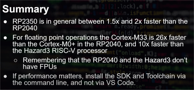

Summary using Linux and a compiler with tweaked settings, showing massive improvements relative to the standard Windows toolchain (from the video):

There are errors in his video. The RP2350 only has a single precision H/W FPU and a double precision software co-processor that is better than the compiler but not hugely (neither accessible from the RISC processors). I don't know how he managed to get windows to compile so badly but my environment doesn't (tested against a build on a Pi5 with a hand installed SDK - no difference).
You don't want to believe everything you see on the internet
